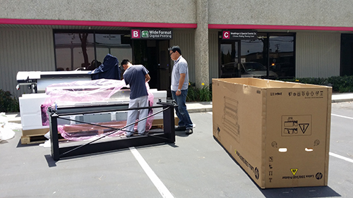

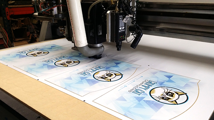

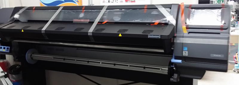

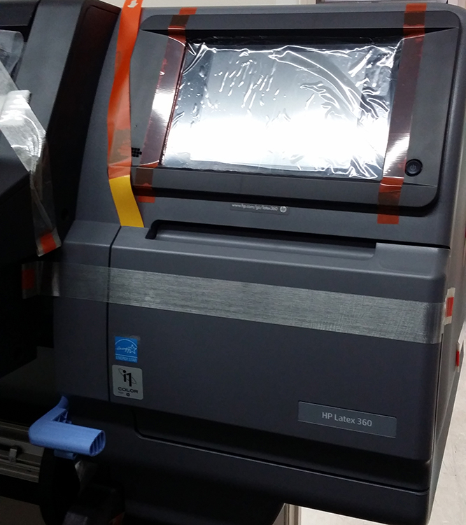

Properly I am the 1st one in Orange, CA got this printer :)

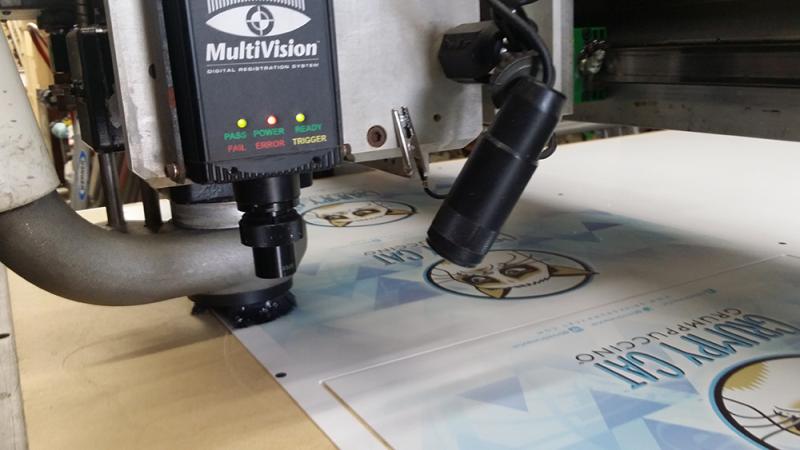

Also additional used Multicam 1000 with Multivision (in Florida) bought from Global Garage up and running very nice.
Now our equip should be good for Southern CA Wholesale: HP Latex LX850 10ft, 2 HP Latex L28500 104", HP Latex 360, HP FB500 UV, Multicam 1000 with Multivision, Roland VS640, US Tech 64" Laminate, Automatic Grommets,

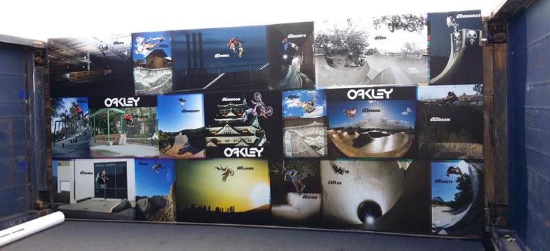

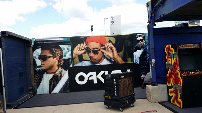

Xgame - Oakley Booth print on HP Latex 360
Here are some pictures
Project printed with HP Latex 360 wall mural printed on GF Concept 222 install direct on plywood 8'x20' (NO LAMINATION WITHOUT ANY SCRATCH WHEN INSTALL)
Oakley logo was print on Oracal clear adhesive and mount on brush aluminum router from our Multicam router with glow LED behind.
X-GAME project in Austin TX - We drove out there from Orange, California on Tuesday (6/3) install and drove back on to CA on Thursday night (6/5)

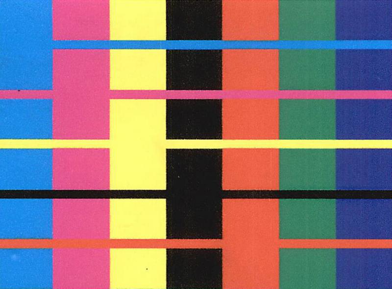

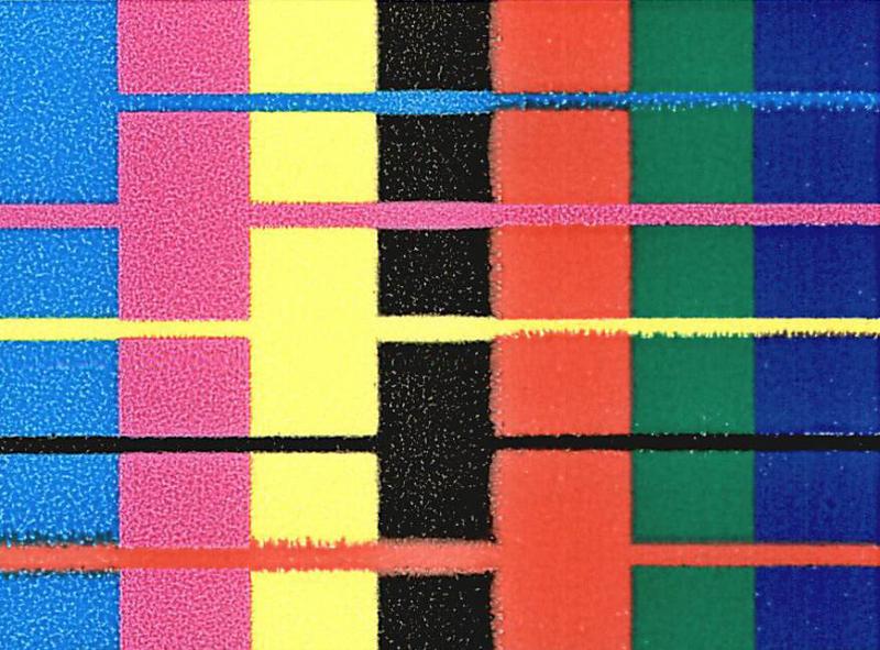

FrankW
I don't know the exact percentage, I have tried something with two extreme values, one time optimizer value = 0, other time optimizer value = 50 (100 possible) ... I'm shure a lower level could help too.
Attached please find samples on a cheap white label monomeric vinyl, 6-Pass-Printmode. The print sample is the internal ink limit swatch at 90% ink coverage.
Sample without any Optimizer:
Sample with an Optimizer-Level of 50:
The main purpose for optimizer is to increase speed. Don't know how it will work on fabrics.
I understand the speed issue, but I am really wondering about is what effect it has on the can't lay down much ink products in regards to increasing color gamut.
2B
those are some sharp lines
how does the cost compare with /without the optimizer?
what is the speed increased by?
Fabrics (especially uncoated woven and knit polyester) are highly absorptive and the rough surface tends to cause ink to migrate into the yarn. This tends to restrict the color gamut that can be produced, due to the fact that relatively little ink remains on the surface to reflect light off of. The optimizer does not change this.
Dye sublimation inks are still the best bet where large-gamut is the goal.
