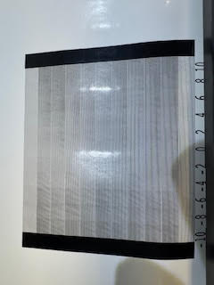

I have replace all the ink. I change out all the heads had to do manual head alignment because of the ink bleed. There is a picture below . I have tried different Media and profiles and still no luck
I’m not sure where to turn now . machine does not show any errors.

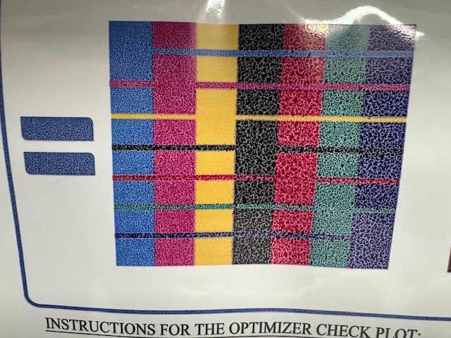

Here are more pictures

Mr.Bundy
I have replaced optimizer cartage, I have replaced optimizer print head. I have replaced trailing cable since its started to tell me trailing cable not connected so I replaced it . Still not getting optimizer. what should I do know.
