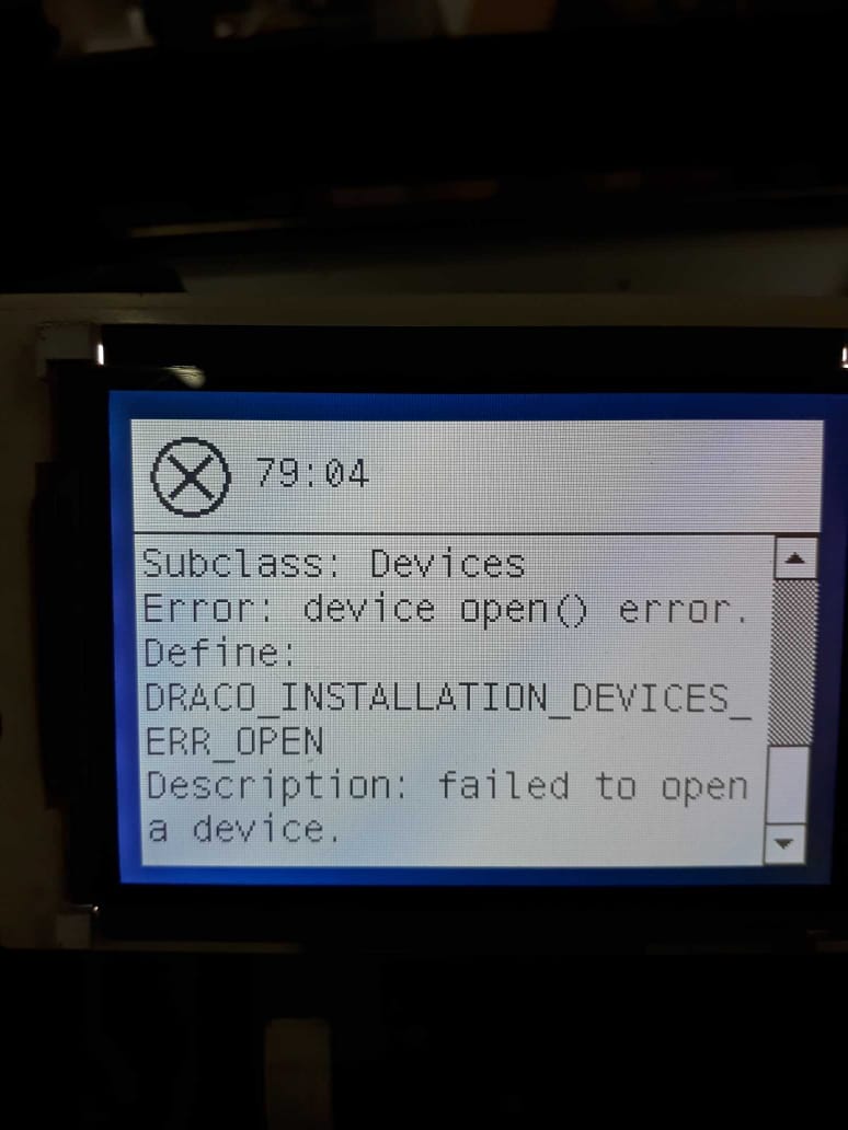

Hi,
I have an hp latex L26500 , I got an error 79:04 , I upgraded the firmware it works for a day an next day the same problem and the error at the start up, i rest the eprom with no help , I did a disk recovery it make the printer restart and the HP logo appears with % counting it reach the 100% and for an hour , each time i restart the machine it count till 100% and stuck on that.
Any help please

Did you read the "How to troubleshoot the 79:04 System Error" from the manual? It has many pages about this error.
Since you ended up like this, I'd probably try replacing the HDD. But it can be pretty much anything at this point.

I did all the tests in the service manual, everything is fine and most of the 79:04 problems comes after the startup , but in my case I can't reach the panel menu
ppnai
I changed the battery and I changed the hard disk , I removed all the consumables, Ink-Printheads - Maintenance cartridge with no hope , after it finish the countdown on the front panel it gives the code directly, I'm stuck on that.
Attached is the log details.

Yes I’ve done all of that.
