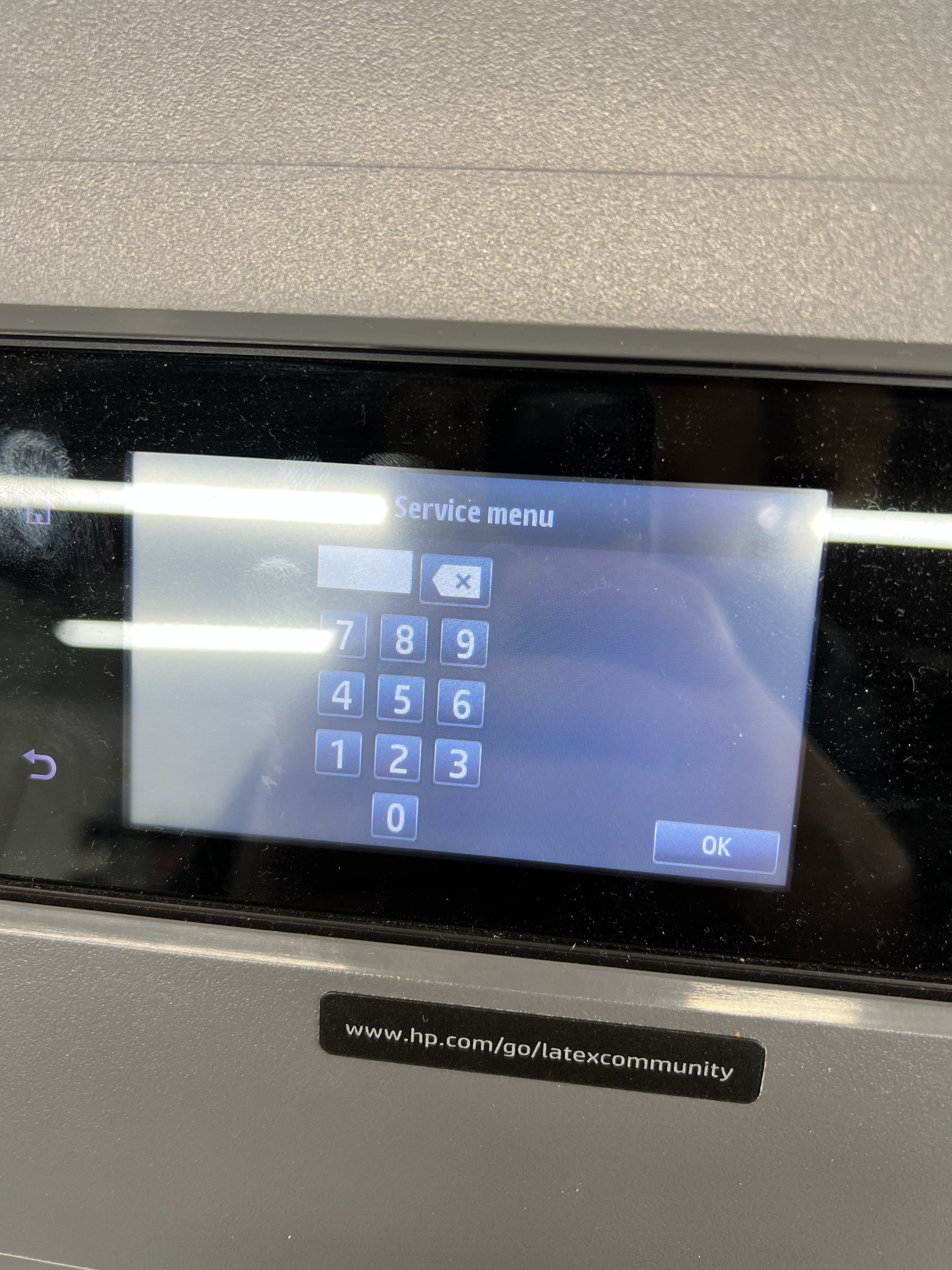

I would check that network cable is properly connected and then run hard disk recovery from service menu. Usually fixes those.

This might be a stupid question but what are the steps to find the hard disk recovery in the service menu? I can’t seem to find it.

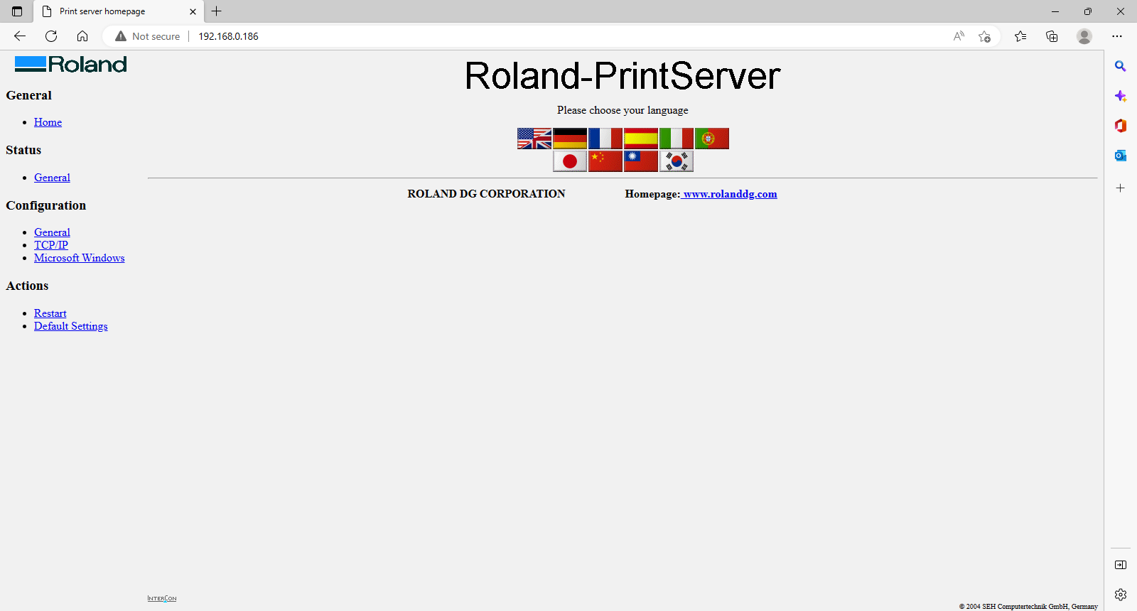

The link light is still on and when i type the ip address into my browser the printer comes up and is connected.

when you http:// your printer ip address comes up do you see a splash screen from the web server
or has your ip been given away to another device?
if getting a blank screen or otherwise not what you expected, hard drive recovery seems to be exactly what you need
balstestrat
Problem Solver
Man, I always find it kindly silly that you tell folks to run something from the service menu and don't provide the access code. I mean, I get that you "can't", not saying you should, but I have yet to find out how to come up with this service code without hunting down a copy of the service manual.
So really, how is any given printer owner supposed to get that code?
I've seen it and manual posted many times. Little search should bring it up.
