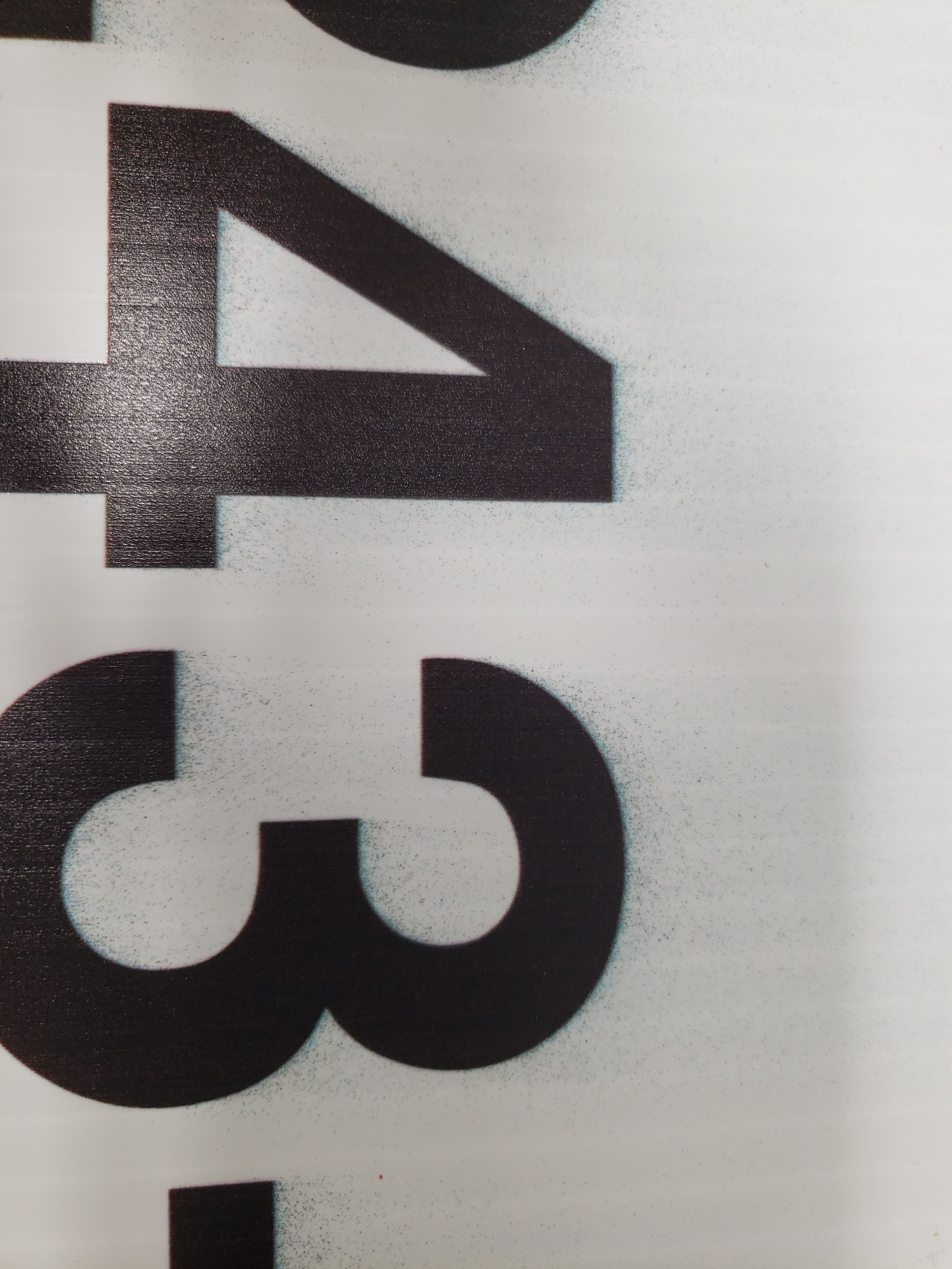

Recently discovered black is printing with a fuzzy/splattered effect at the edges. Jet health is ok. I've tried running purges, shaking ink, emptying and refilling printhead. Any other ideas?
Edit - I should add this is only happening with black. Other colors are fine.
I've attached an image for an example:

Bad batch of ink. We've had three bad batches in the past 2 months. Buy a new black ink, empty/refill the head 2-3 times and it'll be fixed. Lots and lots of people are having this issue right now. HP will send you a new ink if you call it into them.

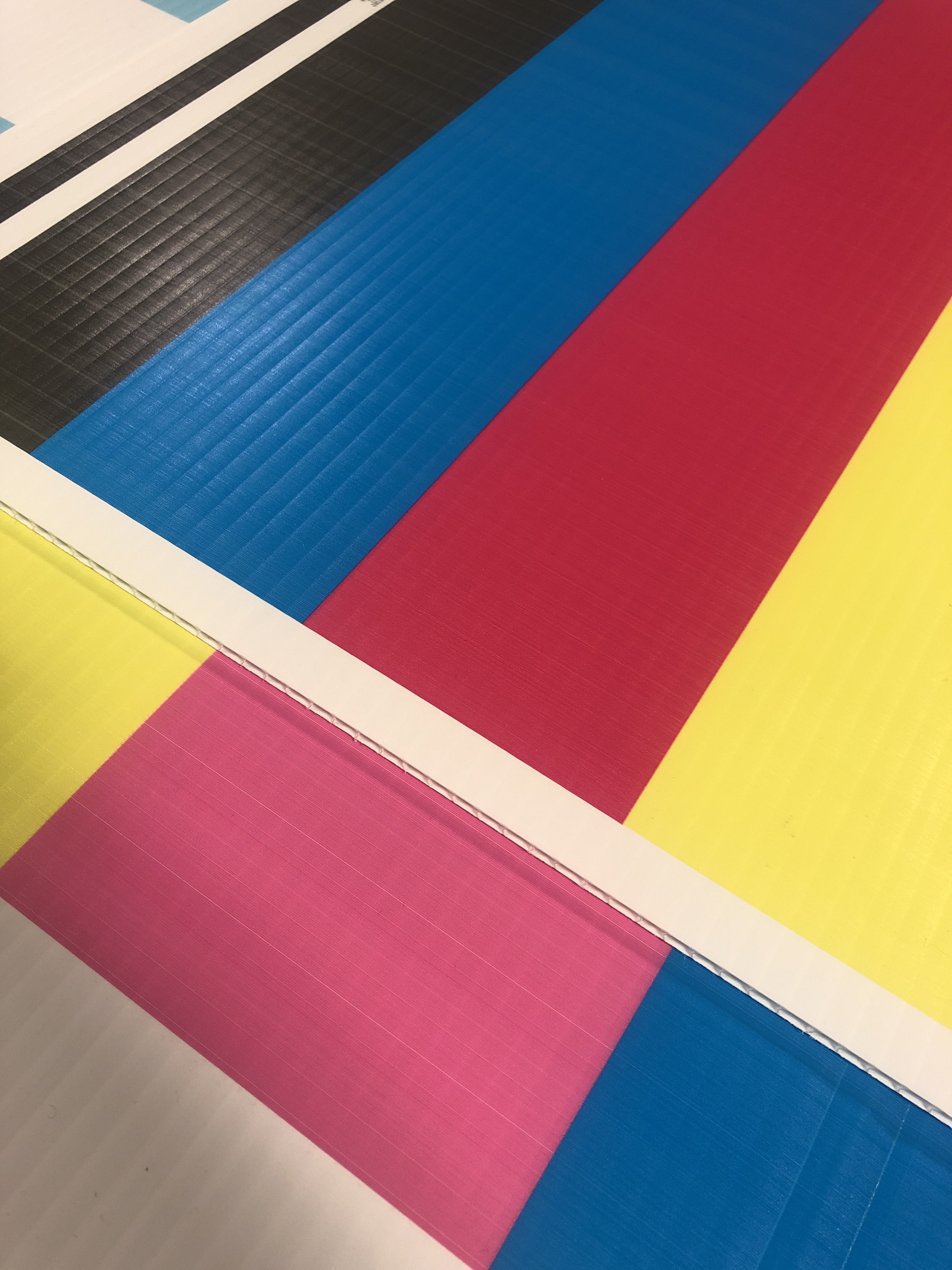

Ever since switching to nazdar we haven't had a single issue with the misting. Customers haven't complained about anything... And our red is more red. I'll upload a photo of our pure 100% magenta print... The hp magenta is way more pink/light than nazdars. We actually can get really nice reds with the nazdar, where with genuine ink we could.get decent reds after Profiling.. but nothing as good as this.

So top is nazdar ink.. just 100% magenta. Bottom is hps. It's supposed to be a "plug and play close color match" but you can see it's different. Imo, it gives better reds... We've switched magenta, lm, and black so far. Lm and bk were spot on. No idea.about cyan yet. But be prepared for a small color shift if you make the change

That’s not bad batch of ink. It’s low humidity in the room. We had that issue one winter. Check humidity in the room it was at 15%.We bought a humidifier and humidity went back to 40% and it went away.
oh wow that is a massive difference. that has pushed me a little more in their direction. it was tough to make the justification for it considering we still have our full service contract for it due to us being a decently high volume shop and cant afford for it to be down for any length of time. this has pushed me considerably closer. is it cool if i check in a bit down the line and see how things are going. could switch by next year. we may be looking to replace it at some point within the next 18 months so it could be an option to lower COO for the end of the printers life anyway.

It's too uniform to be low humidity. Low humidity oversprays due to static and it grabbing the ink - there would.be drops everywhere, not just on the edges. We have a humidifier as well because we get the same issues, especially in winter.

On second look i notice it’s only on one direction (left or right, not sure which direction was your print going) which makes you correct it should be everywhere when there is static. Try going to tools menu on bottom of screen and do bidirectional calibration. It seems like your printer over spraying since it loosing its spot.
This is likely the problem. We have had the same problem in the last 3 months. HP admitted they had massive amounts of ink problems with a recent manufacturer. Get a new box from with a later date on it and empty and refill the heads.

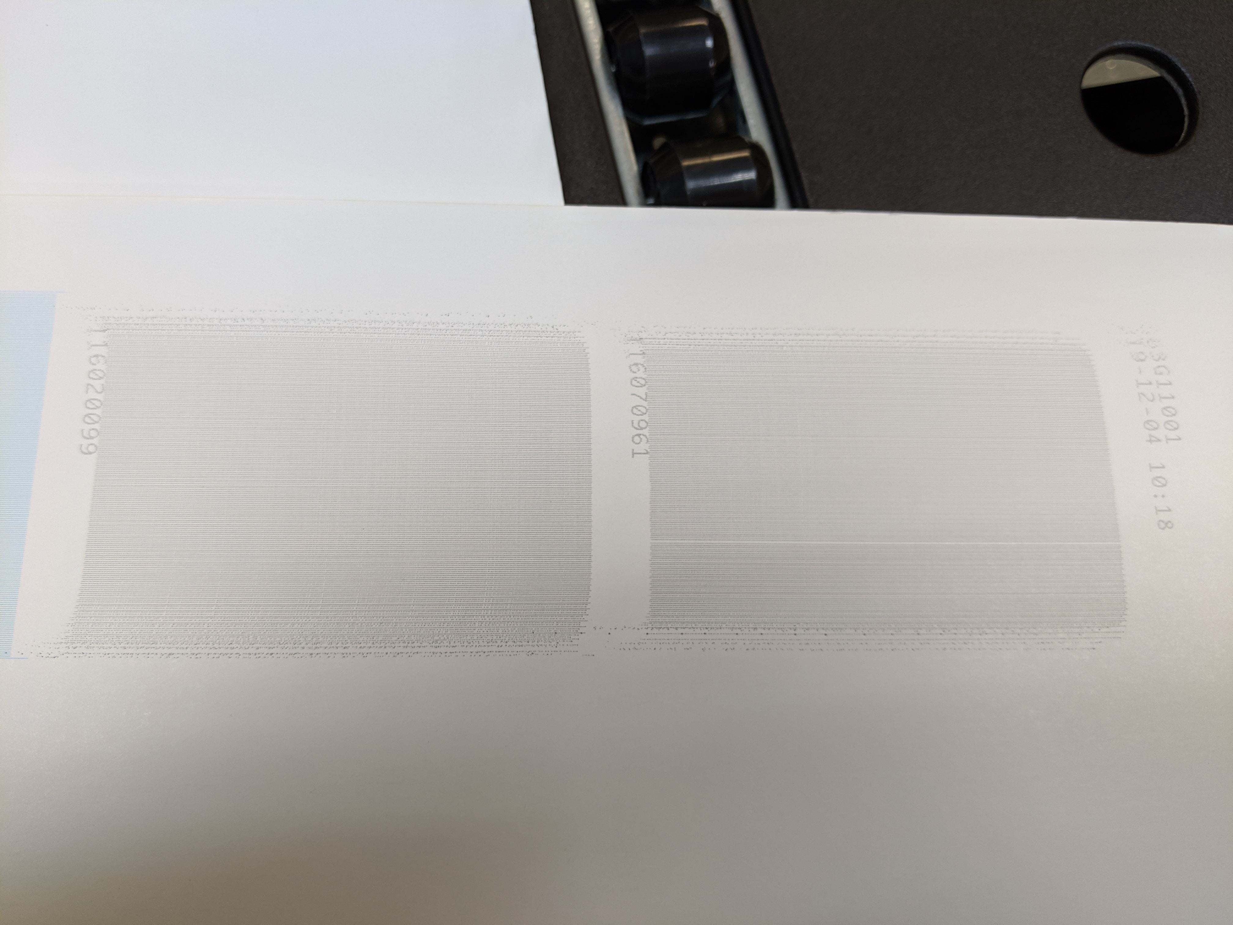

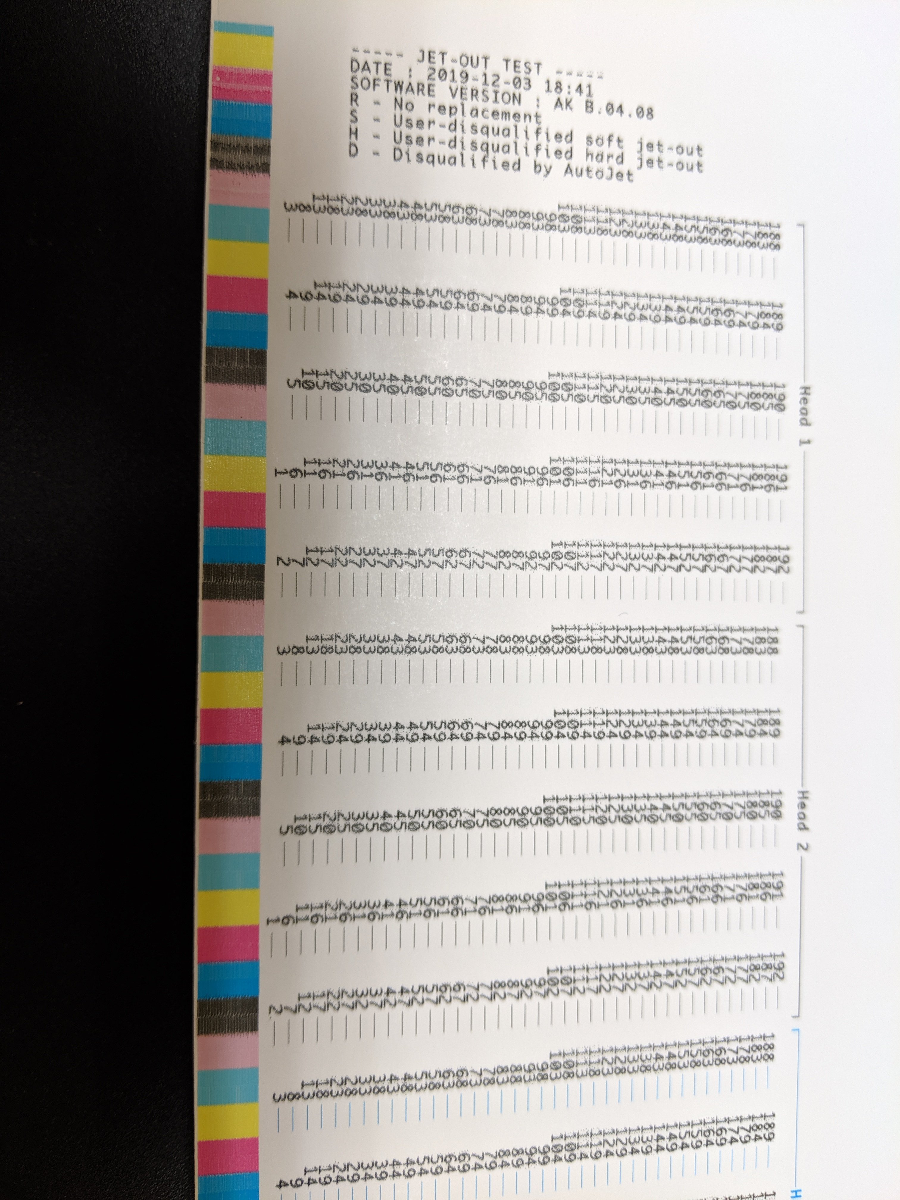

I'm worried I may have the same issue. At first i thought maybe it was a damaged head or bidi calibration out of whack as any text/bidi lines were blurry, but the jet mapping shows all nozzles firing fully. However, the prime bar looks like crap. Can anyone suggest if this is a bad batch of ink or is there another problem I should address?

thats a pretty telltale sign in the primebars there. do you have another black ink on hand that is a different lot/expiration date??
Unfortunately I do not have one on hand. The current ink is only a month old or so with a warranty until July 2020. I just created a case with HP support after so many people said it looks like an ink issue, so hopefully that will deliver some results. Thanks for the quick response!
