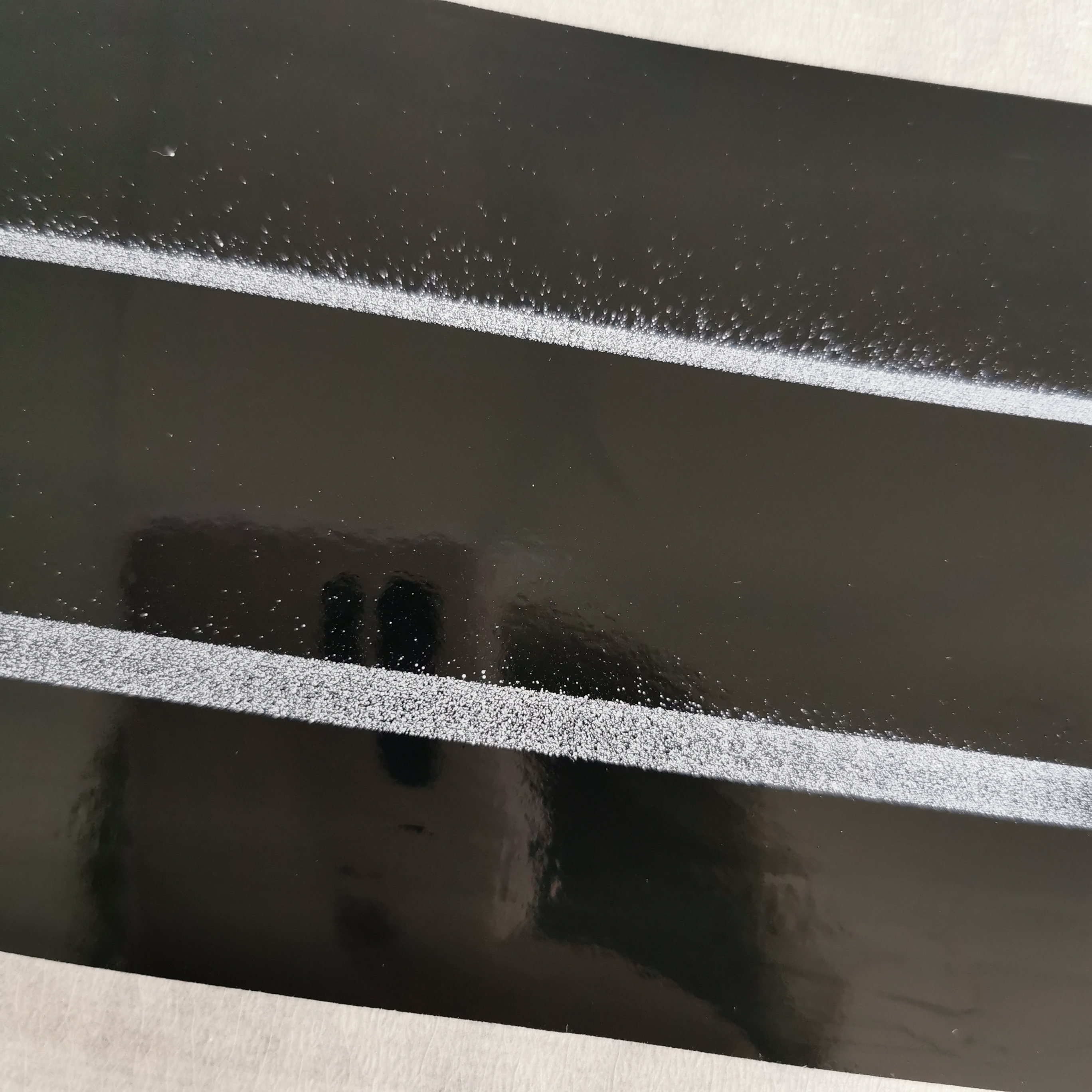

Need Help HP Scitex FB550 black printing with fuzzy/splattered edges

Any one with the same problem but with white ink?

I had my first issue on September 2019.i was told that there are issues with black, magenta and white magenta because of bad storage circumstances.
Then I got another ink box of black. When I tried to change there was no ink coming out. So I checked the filter of the ink. And there was a massive dried built up ink layer on it. So I sent it back and got a new box. It was better but didn't solve my issue.
When I changed the ink box and did empty/refill the prime bar came out OK, but after a while the issue came back.
Now my black, cyan, light cyan, light magenta are gone. They have the same issue. Only the magenta and the yellow are OK.
It has been more than a year and my problem hasn't been solved. I was always told that the Hp change the bad ink box and that's all.
