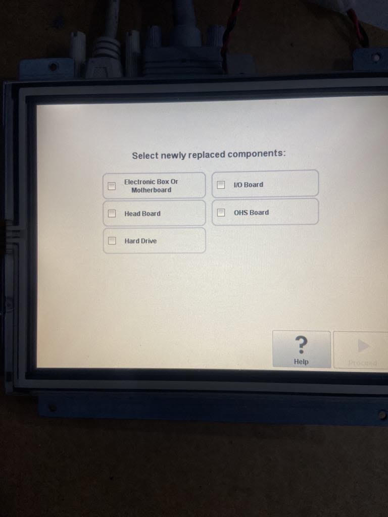

Pershendetje une kam nje problem me hp scitex fb550 problemi eshte se mami eshte prishur dhe e nderroja me pllake te re...deri tani jemi mire.
Pas ndezjes së hp scitex fb550, fillon inicializimi i skedarëve dhe pas një kohe në ekran shfaqet një njoftim: "Zgjidhni komponentët e sapo zëvendësuar:"
dhe dua te zgjedh elektronivc box ose matherboard por nuk me lejon te prek tani kam dy mendime ne kete rast blloku eshte kompjuteri i makines por ka dhe mundesi prekje.

Hello, I have a problem with hp scitex fb550, the problem is that the mother board is broken and I replaced it with a new board... so far we are fine.
After turning on the hp scitex fb550, initialization of the files starts and after a while a notification appears on the screen: "Select newly replaced components:"
and I want to choose electronivc box or Matherboard, but it doesn't allow me to touch, now I have two thoughts in this case, the block is the computer of the car, but there is also the possibility of touch
