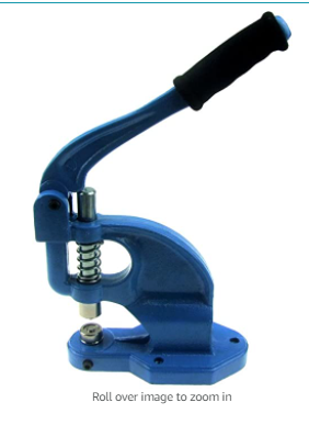

Mine is just a hand punch and it works extremely well. I do several banners a week. This is what I have from Amazon...I paid $55.99 for it and it came with 900 grommets.
{SNIP}
I have the same one.
The grommets that it shipped with were only brass plated steel and rust fairly quickly.
My 390 odd are in a landfill somewhere. I purchased brass grommets and only used a handful before switching to the Banner Ups.

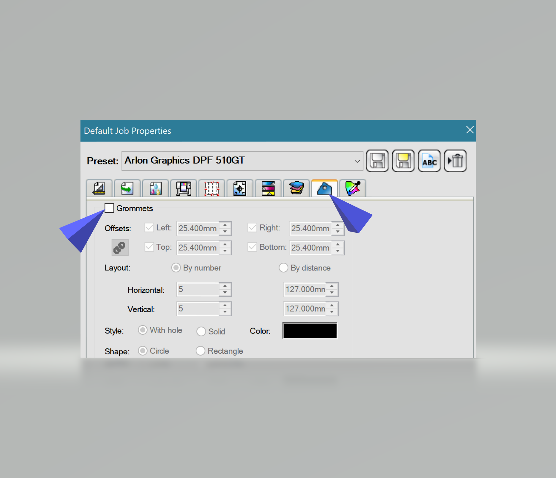

I just put one in each corner and do a quick half fold add another then fold again add another. I never thought of printing a spot on the banner...I feel pretty dumb now LOL
But...I've only had my printer a few months so that's my excuse!
I assume you're using Flexi, if you are, Production Manager -> Default Job Settings -> Finishing Tab -> check the Grommets box, enter the desired locations -> Print.

Her profile says she has an L115 & Summa cutter so it's probably safe to assume she bought a print/cut setup which comes bundled with HP Flexi Print and Cut that includes Production Manager as the RIP. The Finishing tools, colour adjustment, labels & marks etc is setup in the PM Default Job Settings.
The options popup appears when you send the job to PM.
You may have only had Flexi Design which doesn't include the RIP
