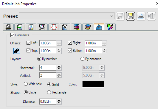

Her profile says she has an L115 & Summa cutter so it's probably safe to assume she bought a print/cut setup which comes bundled with HP Flexi Print and Cut that includes Production Manager as the RIP. The Finishing tools, colour adjustment, labels & marks etc is setup in the PM Default Job Settings.
The options popup appears when you send the job to PM.
You may have only had Flexi Design which doesn't include the RIP

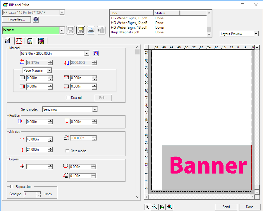

So, I'm in here now and when I do this and click on apply, nothing changes. Shouldn't I be able to see on the banner where the holes are going to be?

I prefer to set the grommets and trim into the file and save it. I use circles that are the same size as the piercing side of the grommet, it's pretty mindless at that point. Then it is easily repeatable without having to remember rip settings. Same with paneling, I just do it in Corel, it takes no time and 5 years down the road I can reprint a panel exactly the same.
That's what we do as well. I only use flexi as a rip station. I don't use any of the extra added functions of it. I stick to corel for all of my art work, etc.
I used to use a circle. Now I use a square and punch the grommet inside the square.
