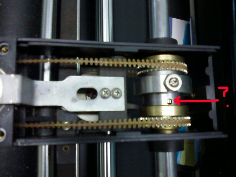

Yes. You will then see the theta belt and the oilite bearing with a chrome shaft running through the middle of it. Check the condition of all the teeth on the theta belt and rotate the oil port up and add one drop of sewing machine or 3-in-One oil.
Marlene
is this the hole? sorry to keep bugging you but I really appreciate the help

THANK YOU!!!!!! I put the oil in that little hole and did a test run on the lettering that came out all wavy this morning and it is beautiful!! the old girl is ready for another decade of making letters! if I haven't said it enough lately, I love this site. when I have had a problem, I have always gotten the help needed. it is nice to know I have people out ther that I can count on!!! thanks Fred!:U Rock:

While you have the oil out, put some on a paper towel (preferably not a used one) and wipe a thin film on all the shiny shafts of the machine. On the feed in side, look for the black lifter bar and inspect it for scraps of vinyl and debris that might be stuck to it and clean any off that you find.
Repeat this process including the drop of oil in the theta bearing once every six months.

just wanted to add that since I put the drop of oil in the little hole in the photo, the plotter has been cutting like it is brand new. there's no wavy straight lines and centers of "o" line up perfectly! thanks again Fred for taking the time to help!
