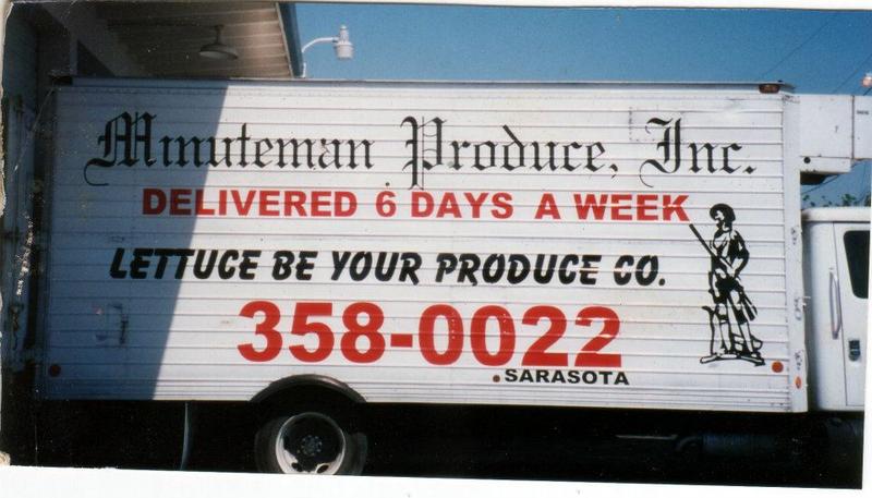

OldPaint
this was VINYL JOB wish i woulda painted it but with the font choice either way was a pain in the arse....and i hung it all single handed...
