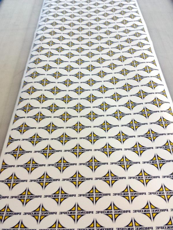

I print custom hydrographic film for the wholesalers / industry. And yes you can print it on Epson Workforce printers, but you need to buy the whole kit. I print it on a different printer though. I can print 1 meter wide x 100 meters long with up to eight separate colors.
So if you have a hankering to put your logo on your rifle, let me know!

nice to know that you can do custom prints, how do you account for distortion to the shape of the item? example a motorcycle gas tank.
also this thread is 3 years old and the OP is no longer here
before you can offer your services you need to get a MM account.
