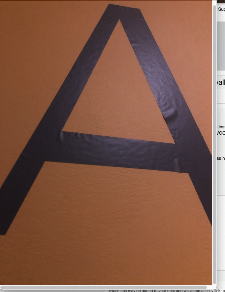

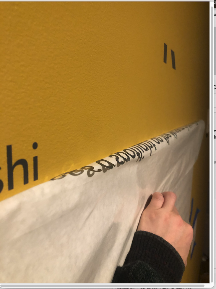

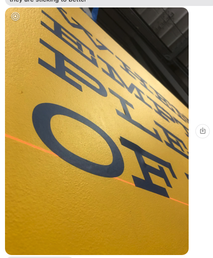

Over the 20 years I been doing this this happened a few times here and there. but now its happening on almost every install with a colored wall. Specifically the material it happens most with is Oracal 631 exhibition matte vinyl on colored walls. We have adjusted the transfer tape, the type of paint used (low VOC paints are worst, but Benjamin Moore Aura seemed to work ok for awhile.)
If anyone has any sort of idea on how to prevent this from happening I am all ears, This problem has cost me countless hours of explanation, excuses and discounts to customers that are understandably furious with the results and amount of time it takes to install it.
