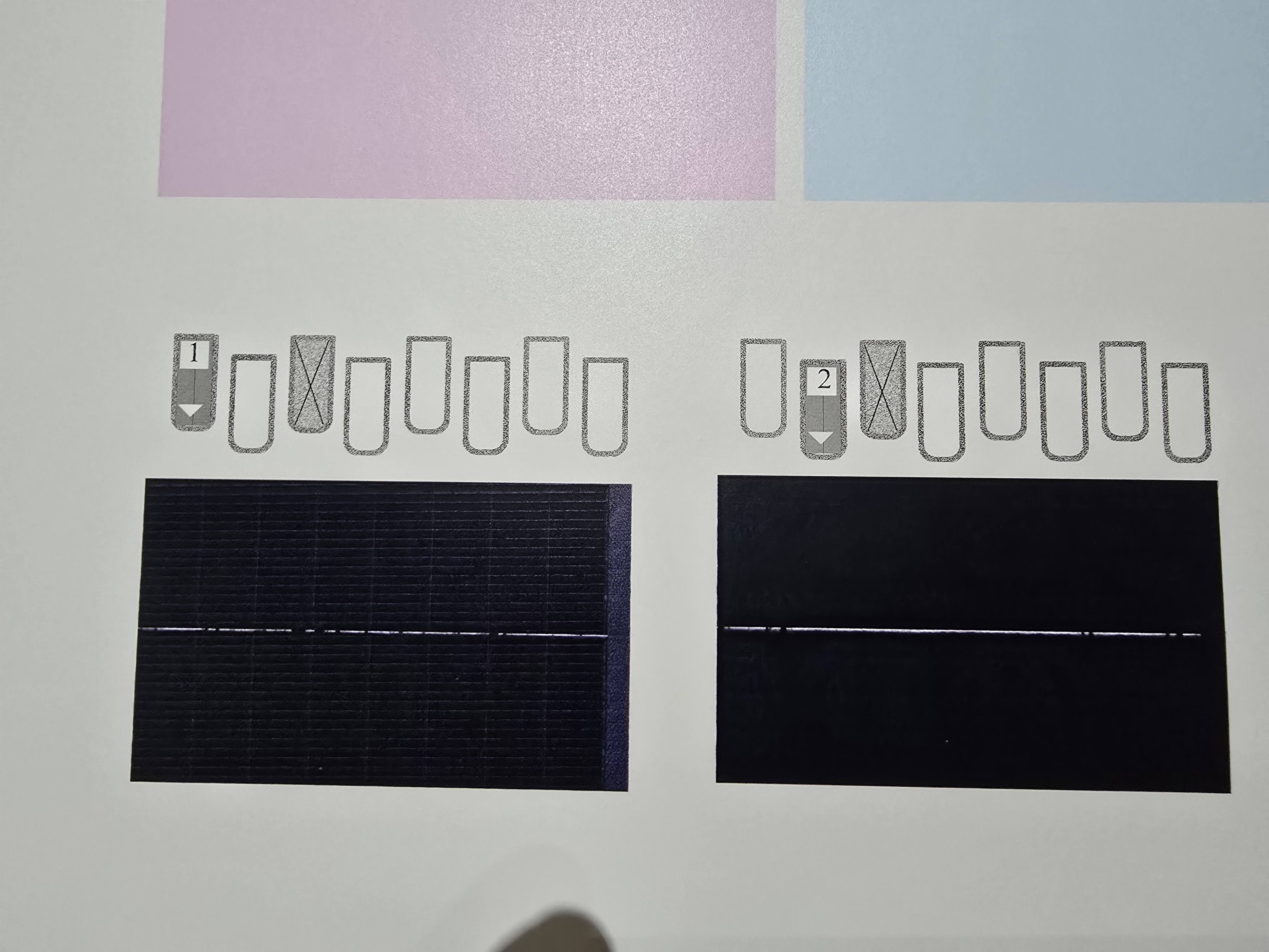

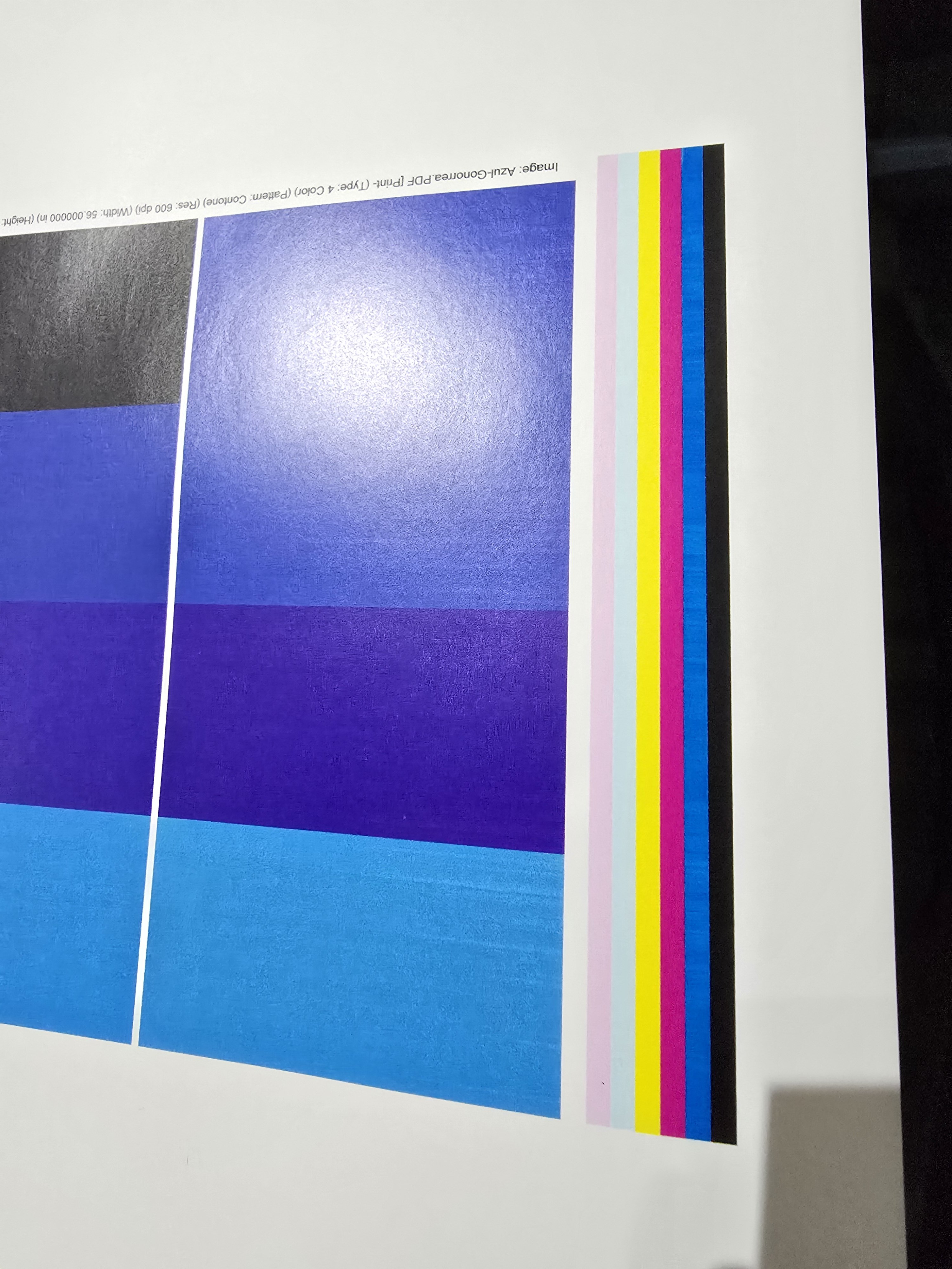

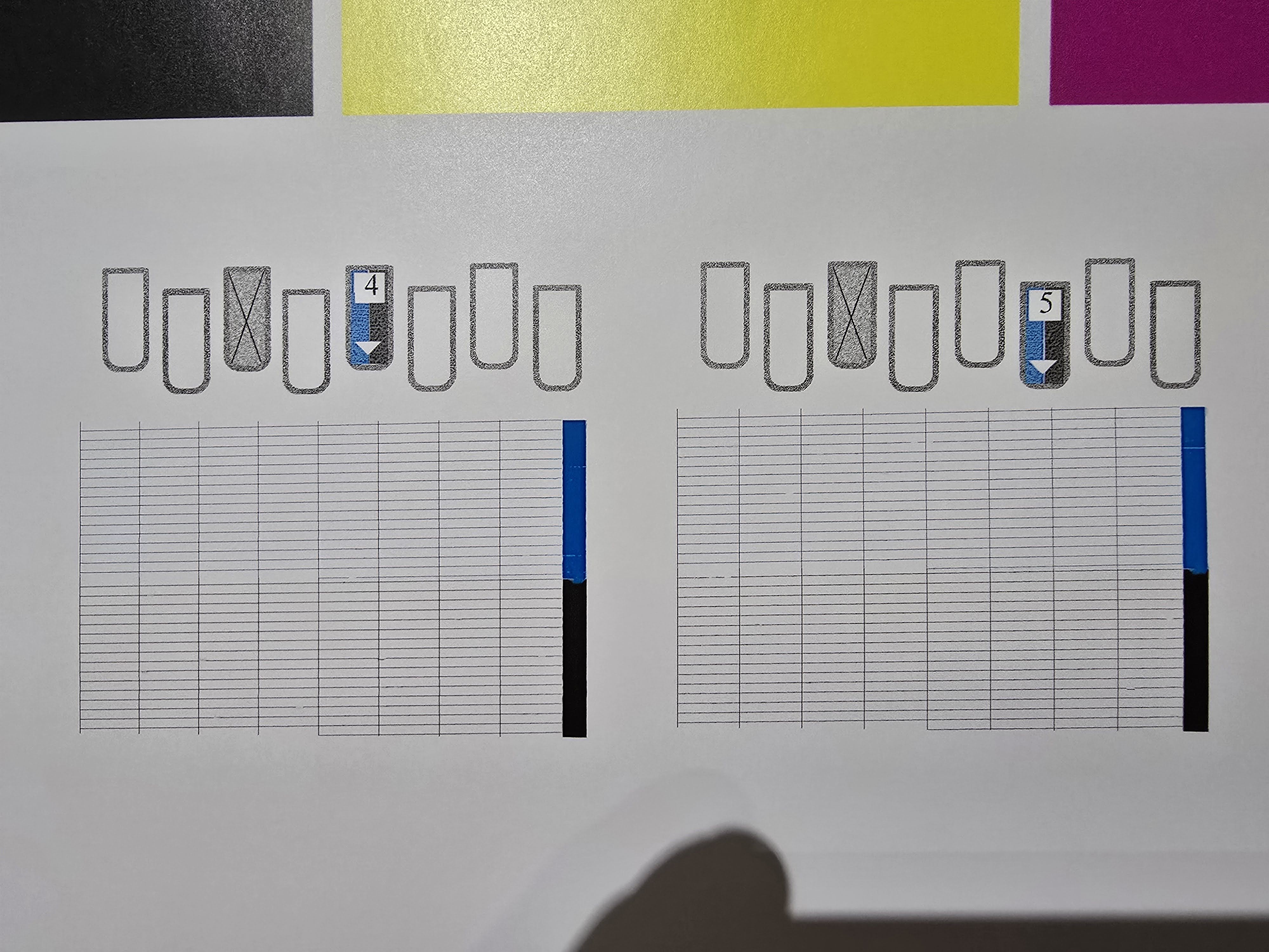

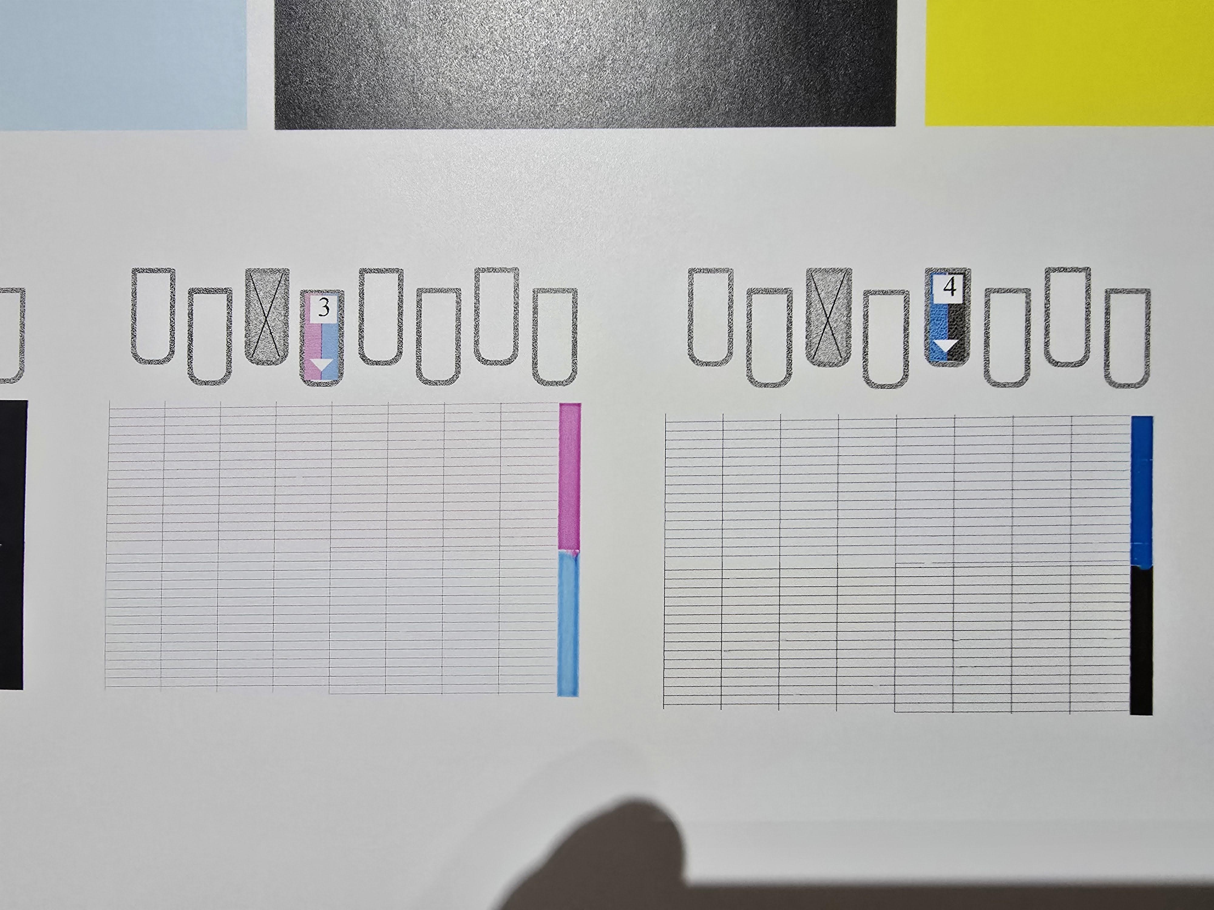

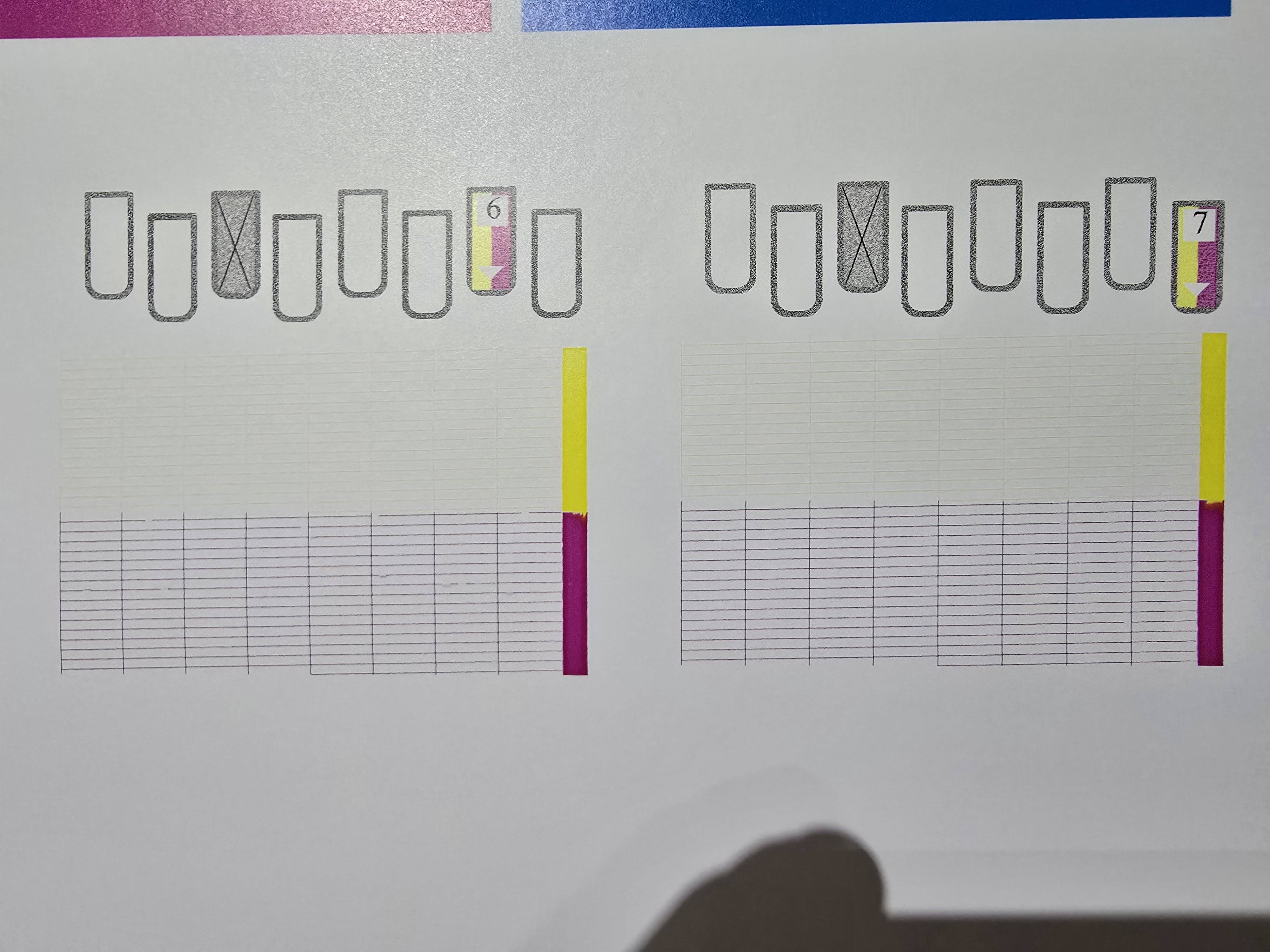

Hi all,
I’m running into a frustrating issue with my HP Latex 570 and I’m hoping someone here can point me in the right direction.
Lately, I’ve been dealing with color issues—mainly with cyan—where there are missing areas in the prints. I’m also seeing ink starvation, but only on one side. On top of that, I’ve had a 98:03 error showing for a while. It used to print fine despite the error, so I assumed it was just a glitch—but now I’m not so sure.
Here’s what I’ve done so far:
  • Replaced both cyan/black printheads
  • Swapped the printheads to test if it was a position-related issue
  • Replaced the intermediate tank
  • Installed a new 3-liter ink cartridge (I thought it could’ve been due to expired ink)
  • Ran a nozzle force drop test – showed little to no nozzle loss
  • Cleaned and re-calibrated the printheads
Unfortunately, the problem is still there. I’ve attached some photos showing exactly what’s going on.
If anyone has experienced something similar or has any suggestions, I’d really appreciate the help. I’m out of ideas over here!
Thanks in advance!

I think the problem here is you first replaced the printheads, contaminating them with the old ink.
Now you must replace the heads... again.
chrisphilipps
It doesn't look like your #2 optimizer print head is printing at all. If you had expired ink in the system that could definitely cause print head issues. Like balstestrat, replacing the print head with expired ink in the printer would just inject the expired inks into the new heads. You either need to print until the expired inks are out and then replace the print heads again or you need to manually syringe the ink lines to get the expired inks out.
cornholio
The 98:03 often comes from the second OP (head 2) head in the 500 printers.
It's almost not used at all.

Have you tried cleaning your encoder strip and the both carriage rails (top/bottom) and platen? Check that you are using the right profile, check that the vacuum is not too high that the media isn't advancing properly?
