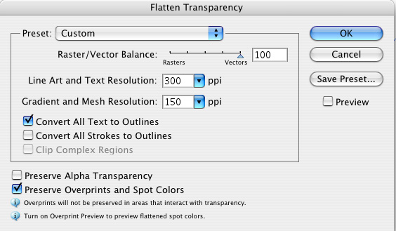

3. The file should display with the bounding box around it. Now click on object -> flatten transparency in the menu. You will get another dialog box to come up. Make sure raster/vector balance is set to 100% vectors. Also check "convert all text to outlines". All other checked boxes are not of great concern when it is the missing font you are after. I have attached a screen shot of the "flatten transparency settings. Click OK.
4. YOU'RE DONE! You now have a pdf file and you did not need the fonts in order to open. IMPORTANT: Keep in mind that this does not help you out if you want to edit the text. If that is needed, then you must buy the font. This simply allows you to open up pdfs without having the necessary fonts installed.

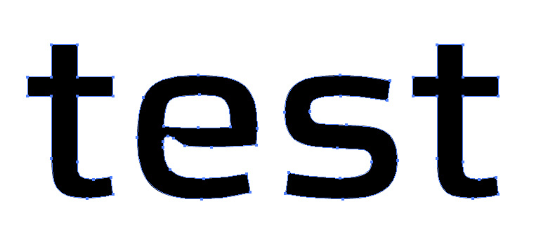

The Vector Doctor
Chief Bezier Manipulator
Interesting, some software must allow this. Does your resulting file look like this? I know some software will convert curves into hundreds of short straight lines - yuck.
