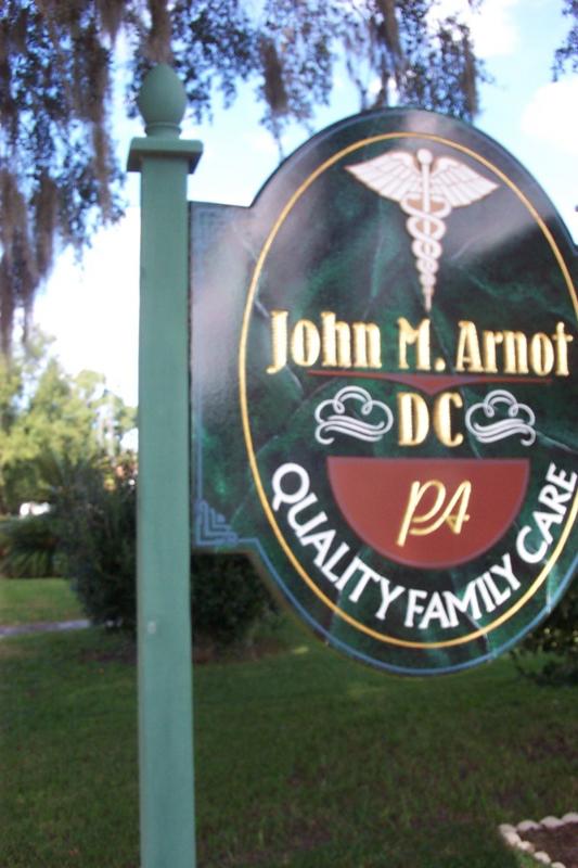

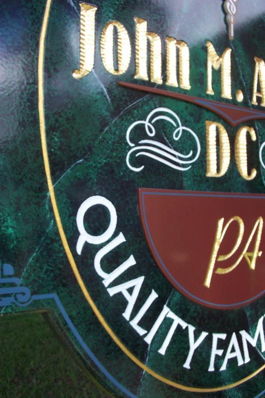

Here's a sign I made eighteen years ago out of sign foam using a jig saw, some swiss carving tools, paint for the faux background, gold leaf, acrylic and even some vinyl. It takes some time but the end result looks nice.
So start scratching that itch...

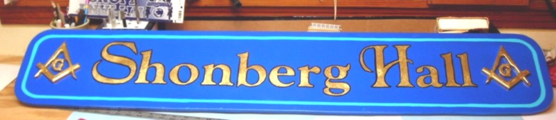

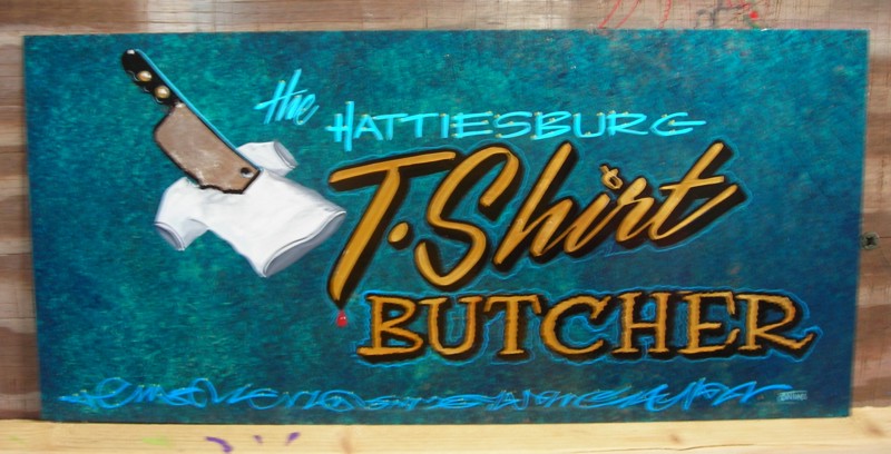

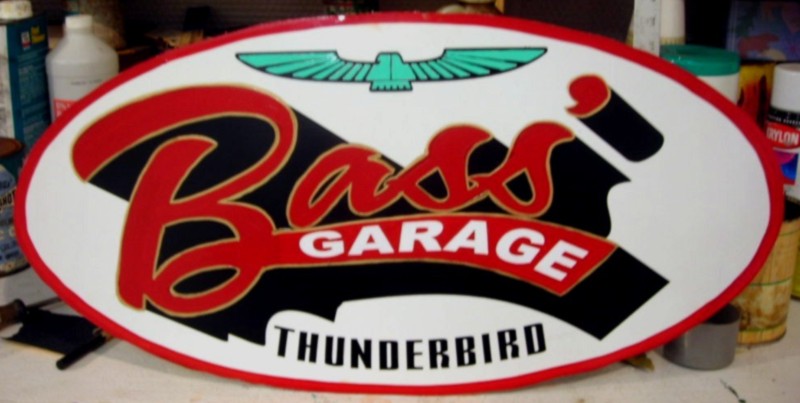

do a small MDO sign CIRCLEVILLE SIGNS!!!do a painted background with some hand painted effects like marble, stone, or some of the foux finishes that people put on walls.
do some small carved raised design in sign foam, and gold leaf the name and hand paint the outline on the letters.
these 3 are examples. the 1st a freind of mine did it, and iam showing it for the background. the middle one is a gold leaf on MDO, with the masonic logo as raised carved sign foam. the BASS is on alumicore, all hand painted, for my wifes cousin whos name is BASS, and he has 4 T-BIRDS!!!!
NOTHIN GREAT, but very satisfying to produce.
