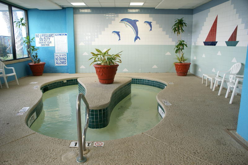

I need a few ideas on this
Wraps ink
I have a project coming up and the client wants to cover these wall with a mural. I dont know if I should wrap the tile or put some kinds of board on the wall over the tile and wrap the board. If so what board would I use? and would the wrap stick to the tile being that there will be moisture in the area. I need some suggestions please
Your bigger concern will probably be getting it clean enough to accept whatever you eventually decide on using. It looks like mold or mildew crawling up that back wall. In a humid room like that, I'm sure they used all kindsa chemicals to keep that place sterile. Your job, should you decide to take it... will be making sure you get it ALL off and prepped properly for installation of your choice.:wink:
Jwalk
It does look a little tricky. Of course I would Prep the tile properly and prime and then do a real mural.:noway:
We have wrapped a few walls of ceramic tile for our military base in their kitchens. It is right there on counters, and areas where they cook. It has worked great. We used 180cv3 with gloss lam. Just used the small 3m roller with heat, and goes right in the grout lines. Looks like tile again when it's all done.
Richo Man
I would be approaching this differently. I would apply your prints with over laminate as normal to Aluminum composite panel and using a strong bond anti mould wet area glue then attach them to the wall that way, I wouldn't even tackle applying print media to the tiles. Too many things could go wrong :Big Laugh
Nuagedesigns
180cv3 all the way. I would not recomend covering the tile with any sort of board or substrate. That has nightmare written all over it. At least with a vinyl film you will not get any mold or moisture behind it and it is easily cleaned. If you mount boards to the tile you are opening yourself up to an enviroment where water, moisture and mold will reak havoc behind the boards and not bee seen or be able to be acessed to be cleaned.
I would clean and prep the area properly then go to town with 3m vcat rollers and heat for the grout lines. A great design will make that pool room look amazing. Be sure to charge accordingly.
