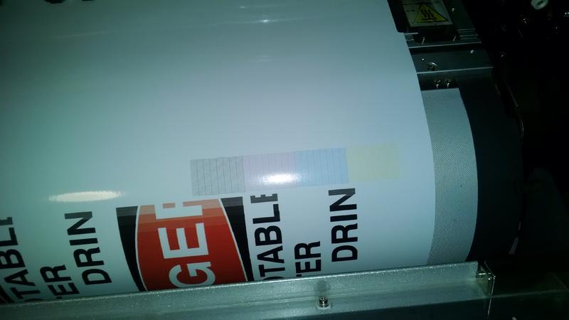

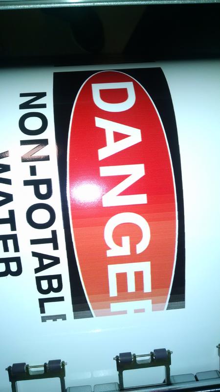

It prints but I think I have a bad slider or main board...it has to be electrical I can do all test prints just fine...no drop of of ink until it is gone
Here are some pictures of what it is doing

Clean the encoder strip behind the head carriage and all the way along with iso alcohol very gently and make sure the strip is in the correct position in /out of the holders, what I see is stepping in the print most likely from dirty encoder strip.

Test Print works fine
After a while all channels drop off and it goes white...I have had bad pumps etc but then the test print shows 1 channel red dropping off
tooserious
Ink flow on all channels???
I did the disway wash and cleaned it out real good all pumps are pumping and it is flowing well

Check to make sure your cap tops are sealing to the heads. Take the individual tubes off each cap top and draw on them with a syringe. If you get a mix of air and ink coming down the tube, the capping station may be bad
artbot
if it is losing data all at once, the next step, if encoder tests and reader replacement (super cheap) don't help, is to pull the slider and main board and send them to macmedia. if one of them is bad, the repair will not be that costly. having a tech arrive at your door will cost more than the machine is worth.

WELL MAYBE new encoder and so far so good
A little steppy but not bad I get the new encoder eye tomorrow and dampers.............God hates the Packers Loves the Seahawks and Loves Mimaki
