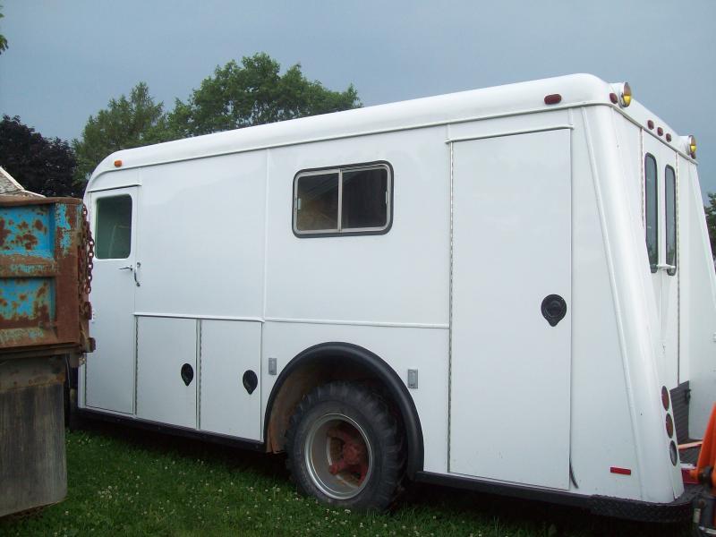

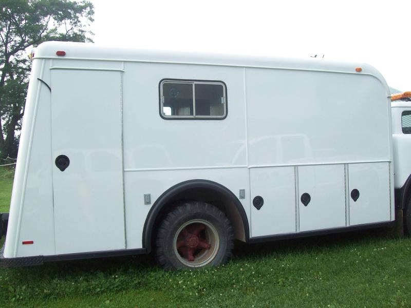

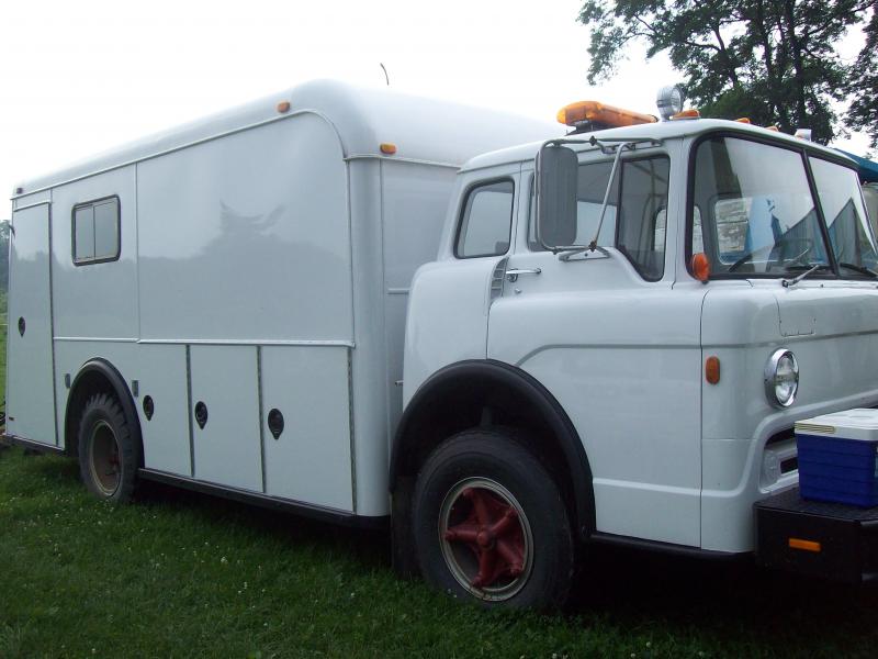

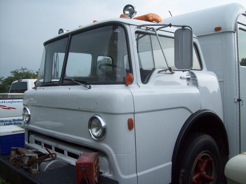

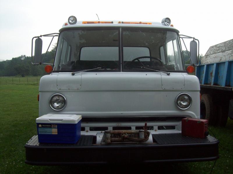

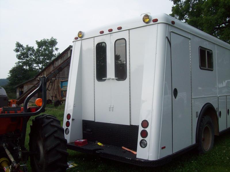

I just had a customer show me a very unique truck he wants lettered and I was wondering if anyone could point me in a direction on where to obtain a template or help on creating one for this truck. The truck is a 1969 Ford 750 with an enclosed box on it. I took some pictures so you can see what it looks like.:help
Thank you!

If you can't find a template take a bunch of straight on pics grab some measurements and scale it up.
I've done it before and found it works well.
That's a neat looking truck

are ya going to wrap it or LETTER it? You already have pics, now just make some measurements....i seriously doubt you'll find a template too and if you did it'd be for the cab only. Letter it up!:thumb:

I will be lettering it. I figured I wouldn't find anything but thought I would give it a shot. As for creating a template I just don't have alot of time.

Tape a yard stick to it, shoot another picture square on. Import picture into your drawing program. Measure the size of the yard stick, rescale to make the yard stick 36".
