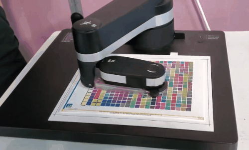

How much money have you got to invest for a spectro?
Some RIP developers offer color management courses. There's a lot to it.

Anything you download that hasn’t been created from your own prints on your own printer(s) isn’t ideal.
You need to look into getting a spectro and creating your own profiles.
netsol
if you use flexi, all you need is. a I1 pro, buy one on ebay
NOT ONE WITH UV CUT
if you will use xrite software, the license needs to be loaded in the spectro when you buy it
probably, $250 - $500

This can be a fun journey, but can also be a rabbit hole. There really is no end to the art and science of color. The more I learn, the more I realize how little I know...
Best of luck to you!
