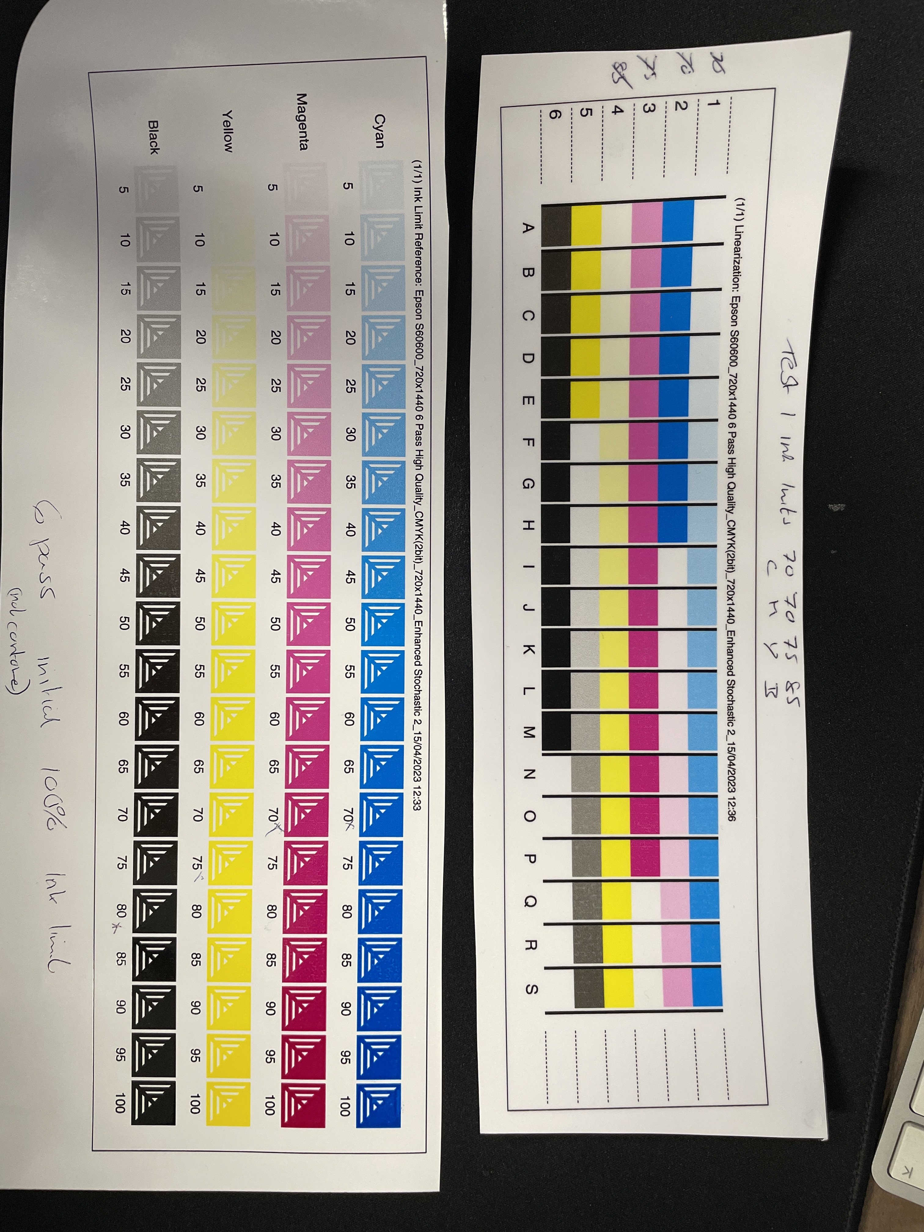

As a rule of thumb, I read some time ago that set these printers to a max of 85% ink which is what I am trying now in a 6pass high quality.

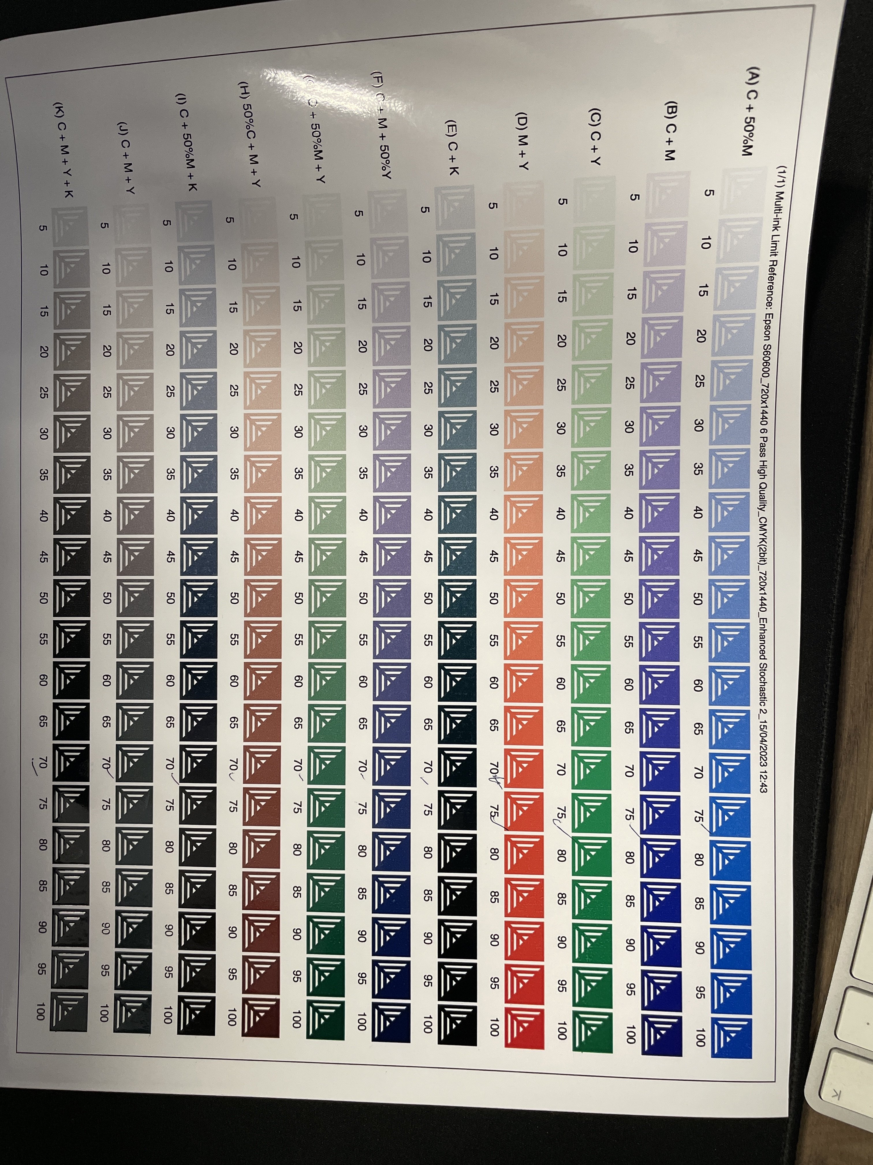

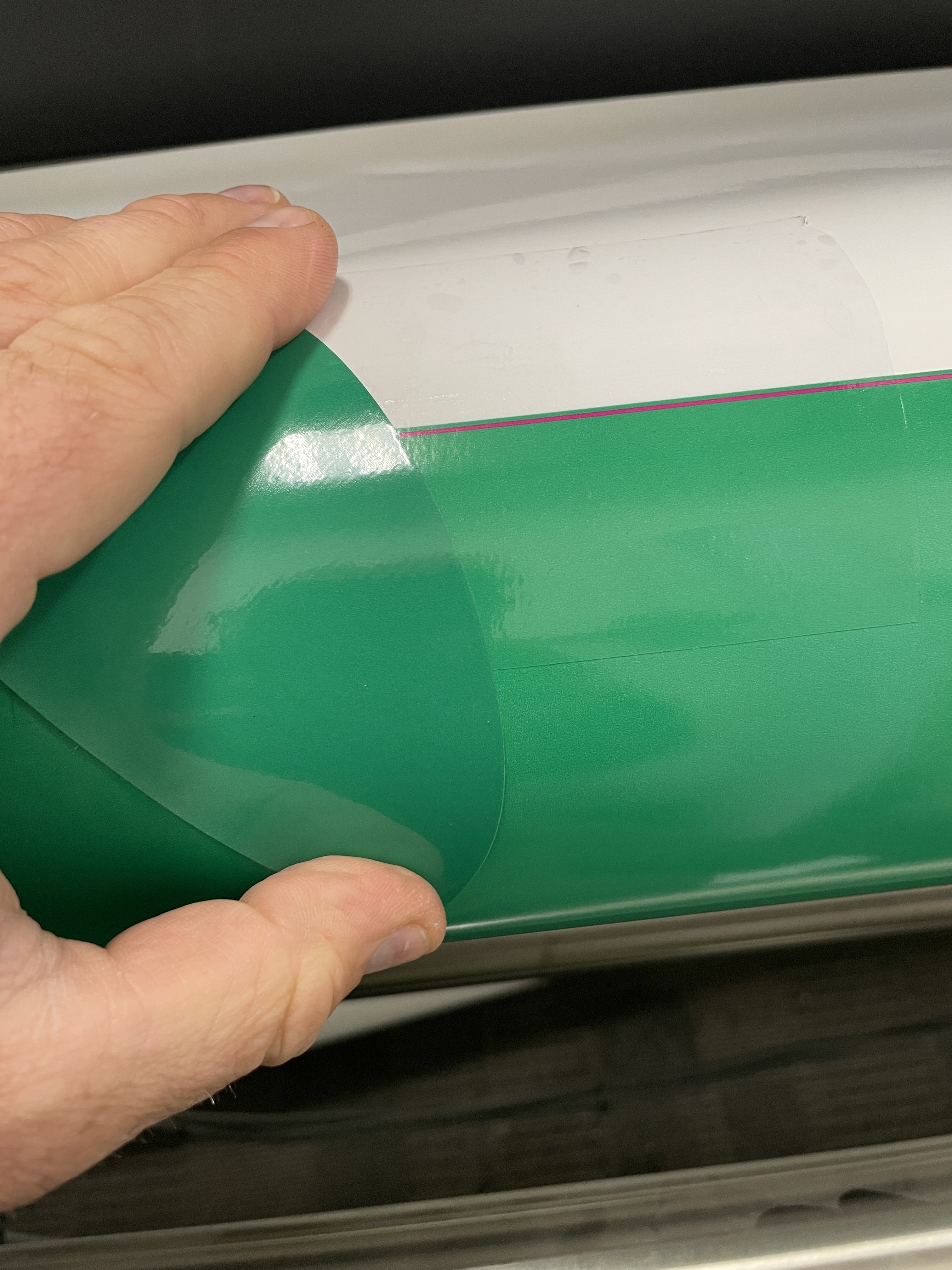

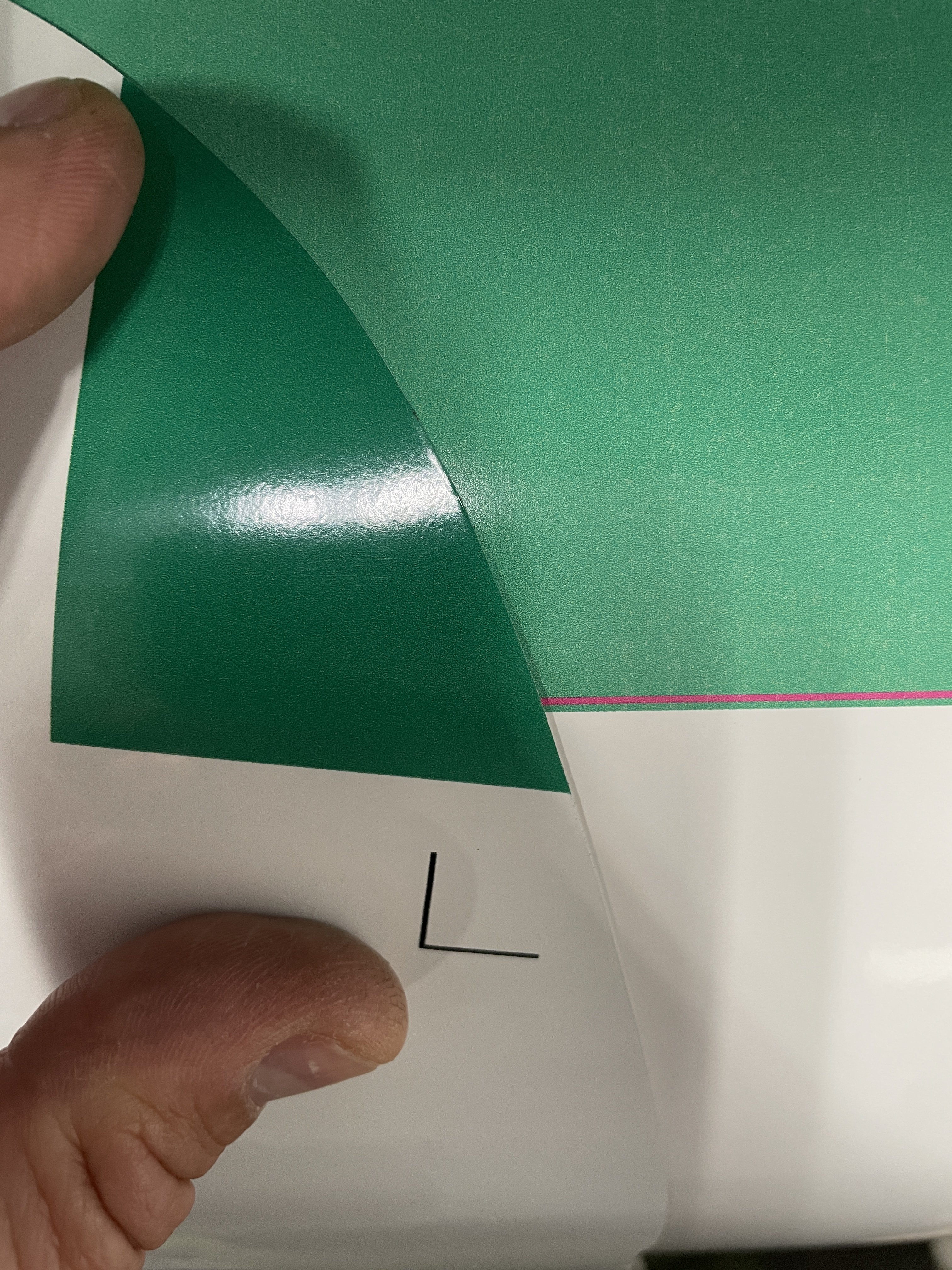

My custom onyx profile (on the left) and my new flexi profile on the right. My new profile looks all washed out compared to my original.
This was printed on 6 pass high quality 720 x 1440 cantone, 85% ink limit, 95% on multi limit and about 1400 patches read.
Mata
I’m getting closer but I am still off.
Here is my latest profile. The one on the right is an 8 pass, my new profile is a 6 pass. Could this be my issue?
The new profile is:
6 pass hq
Adhesive vinyl
720x 1440 (not cantone) 2bit
Enhanced stochastic 2
Ink limits
C 70
M 70
Y 70
B 80
Multi ink limit
75 for the first 4
70 for the rest which are all darker colours
Black generation
Gcrsmooth
0% black start
100% black width
279% total ink
Profile large
Icc version 4
Everything else turned off.
See attached images of my print files for reading

you do your ink limits by looking at the print quality with a loupe.
enough ink for fuull rich color but no bleed or spread
each color will be different don't just set them all the same
