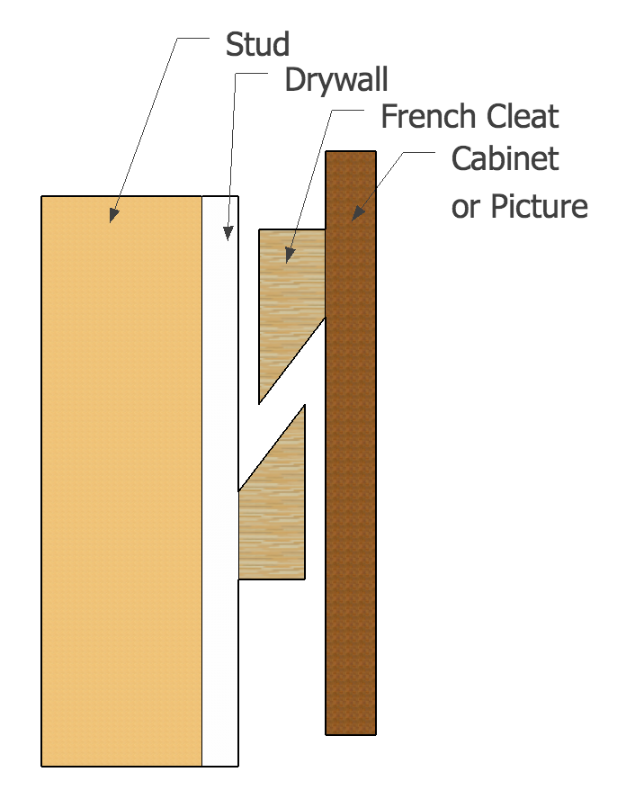

If it's indoors you could try to glue on french cleats. If it's 6mm ACM you could even tap it and screw on the french cleats. That way there's no fasteners to cover up. The picture shows what a french cleat is and how it's supposed to work. frencho.png
