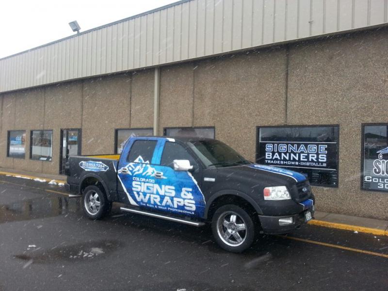

heres one i just completed that is matte and gloss...
the matte is 3m 1080 and the gloss is printed and lamed 180c/8518 overlays.

Awesome we will give this a shot. My only other idea was to print solid black and laminate with matte film (so its laminated) and then print the pattern in black onto the matte lam (exposed). But I suppose that's the same as printing to already matte black vinyl.

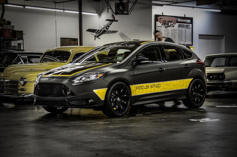

Matte Black with Gloss Overlays Attached.
It looks sexy in person.. just an awesome affect.
