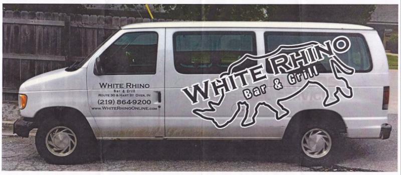

Second post on this site. Was looking for some input on how to apply the attached graphics onto a van. I have put graphics on vehicles before but never this size. As you can see by the pic, the graphic is fairly large and has floating letters and whatever inside the graphic. I though about printing it on white vinyl with a contour cut around the black, weeding and then applying a low tack application tape to the image, hanging from the top and working my way down. The door print isnt a problem. What are your thoughts? Would you do it different? Also, I would probably charge around $500 for the job. Too much? Too little? I got my thick skin on so fire away. I appreciate any help that you all can give.

900+ for something like that.
Print, cut, weed, mask. Apply.
Center Hinge, and work from the center out.
PMac
God I hate that I'm having to compete with people like this.
At least $800 for this. Using cheap cheap vinyl. Like ShineRite or something. Hopefully you can digital print the white and black together as one piece and not have to float the black in on top of the white.
Think of all the prep work alone! This is what you need to do.
Imagine how long it wile take to do this job. Computer time, cutting, masking, cleaning surfaces and installation. And double that time (because that's REALLY how long it's gonna take) and think $60 per hour + materials. You want to make a living at this right?

You just suggested shine rite digitally printed on a vehicle, and you're complaining about competition?
That's a 15 minute per side install. Not a ton of time in the labor of it.
Biker Scout
I hope the van isn't that dirty when you get it, otherwise it will take more time to install. Make sure when they have it cleaned that you tell them not to wax it or you will have to charge extra to remove the wax, or the vinyl will fall off.
But seriously, this has potential to being a really cool van... just gotta kill that crap on the door. But yeah, 30 minutes if you are doing it by yourself.

Great input guys. I have a sc540 so I will print it on white and then contour cut it. hinged in the center is a good idea. Have never done it like that. Center as in center to left then right or center to top and then bottom? And I want my prices comparative. I do work out of my home at the moment, so not much overhead, but I want to do good work and charge accordingly. Thanks again.

See, I'd approach that just the opposite - cut black vinyl for the bodywork and a simple white outline for the windows (to mimic the black inline). No printing involved. I'd still be over $500 simply because it's a colossal waste of material cutting just an outline.

center hinge side to side. lack of overhead dont mean squat - do you have aspirations AT ALL to open a shop location? if so, do you want to have to DRASTICALLY raise your prices when you do?

print-LAMINATE-cut-weed-mask-apply. LAMINATE! I would side hinge this. On installs I kinda go by how I feel, hung over days are different than those rare non-hangover days.
As far as price, LOW I'd be $800-$1000 including two sides and small back door.

Ok simple enough print+lam+cut+weed+transfer tape.
Install center hinge.

For me I would print on air release cast and center hinge perpendicular to the graphic it would take me longer to trim in the windows than to lay the vinyl total 10-20 mins per side including getting place and taped where I want it, and I agree charge more please.
