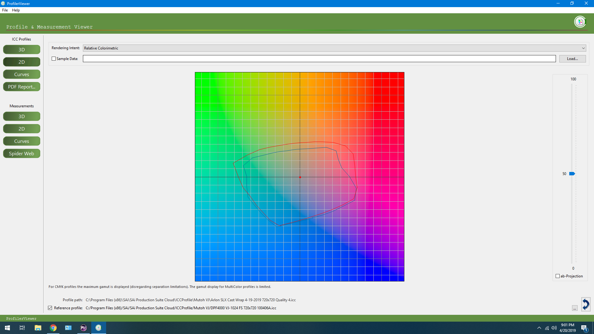

Example being, if I open up the profile viewer or whatever it’s called, I can see the the pre made profile has a fair bit more gamut than the profiles I have been able to make.
Am I missing something here?
I set my ink limits by chroma in i1 profiler.
That average around 80% to 90%. Total ink limit is 307%.

here is what i'm talking about, granted this is one media... but for this particular media its really lacking in the reds.
I should mention that my printer is a VJ1204

Grey: shure you check your samples under correct light conditions? Colour is reflected light, and ICC-calibration is based on light near daylight. Viewing colour samples under artificial light could lead to colour deviations, check it again under daylight.
Gamut: to which value have you set your ink limits?
