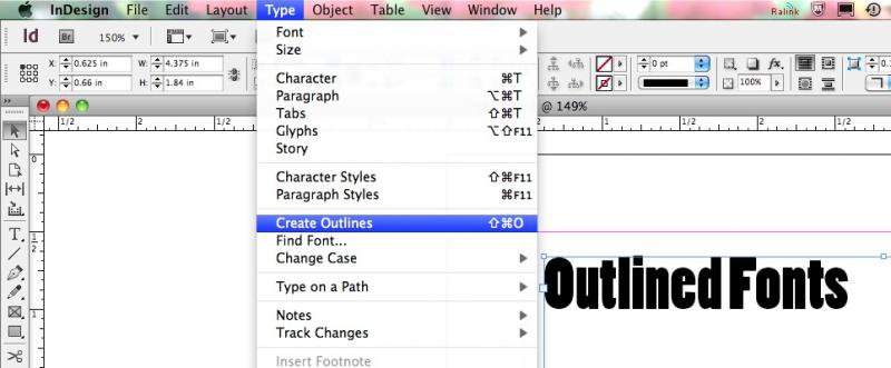

InDesign Outlines fonts!
InDesign does in deed Outline fonts and has for several generations!

Indesign does convert to outlines, but everything else Fred said is true. I bounce from mac to pc every day and there are slight variations. It looks close most of the time. I've also tried to take my font library from my pc to install on my mac at work and I can only install about 80% of the fonts I have because my mac won't support them. For this reason, I just recently set up a virtual machine on my computer to run mac OS X and will be setting up a virtual machine on my mac to run windows 7, so I can see both instantaneously. You do get more variations too if the versions of indesign are different between the machines. Make sure you run whatever version on both!

Outline fonts in Indesign will work but if design with effect or shadow will be default or back to original font, accept outline font 1st and set affect.
