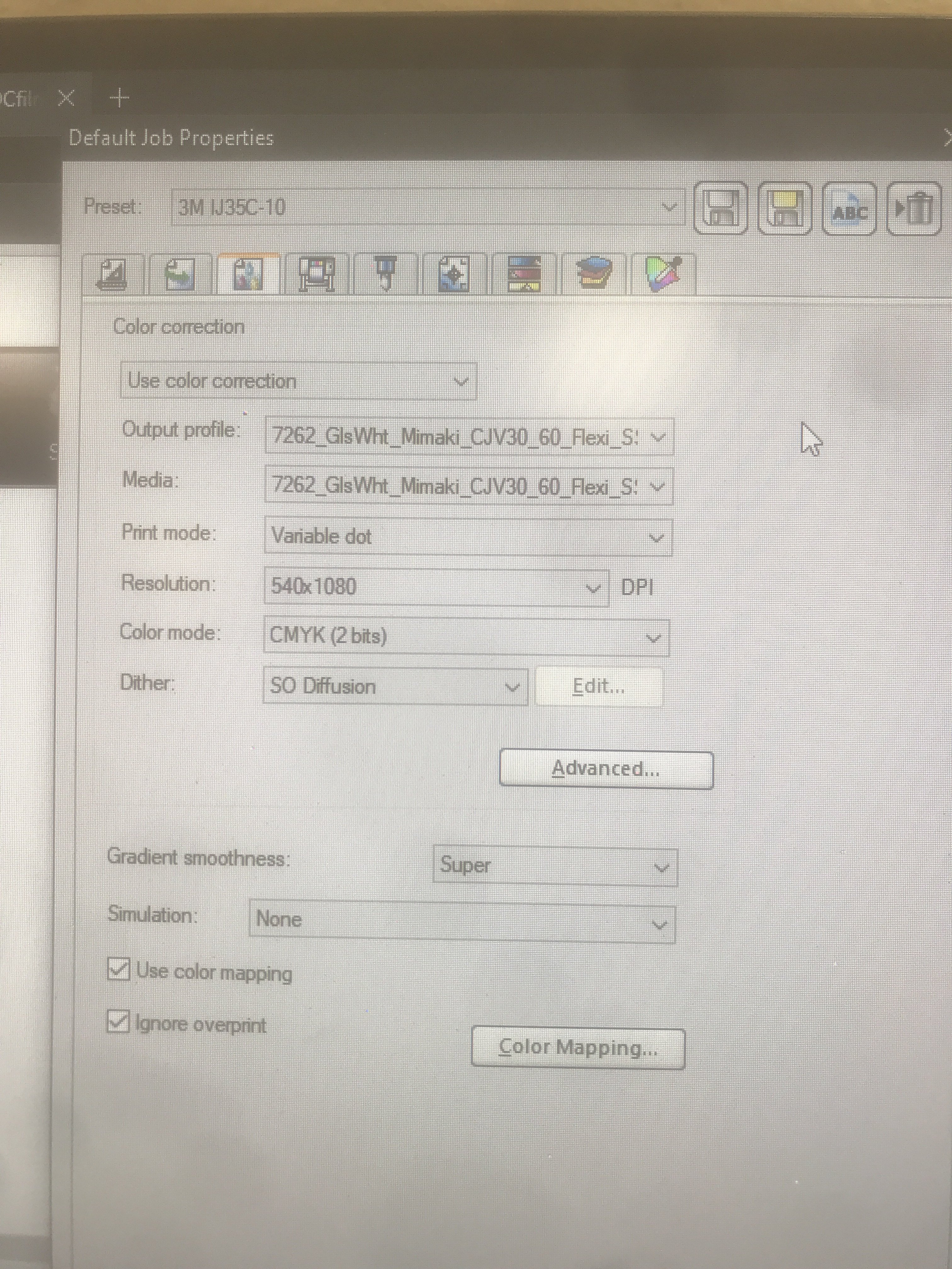

tooler82
Mine was the same way. If you can wait, I’ll let you know Monday what profile I got to work perfectly. What program are you using though? Mimaki or Flexi?

tooler82
Sorry. Was hoping I could find it for you

tooler82
That is weird. 3M didn’t have the one for me but just tried a bunch until one was close to the color on the screen and printed perfect.
