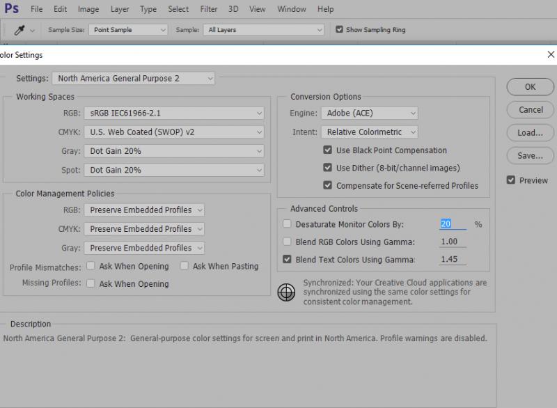

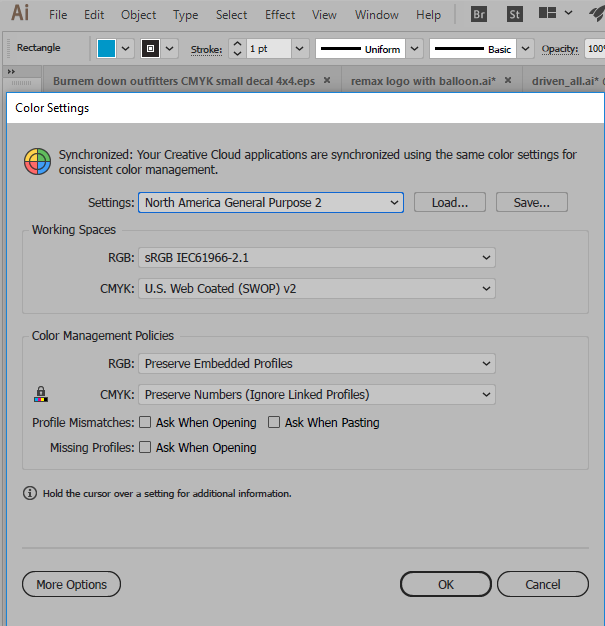

So here are 2 images of a process blue coated printed in illustrator and in photoshop
Not even close to a match.
Any reason?
Here are the color setting of each app. Along with the save as dialog box.
Using onyx 12 rip

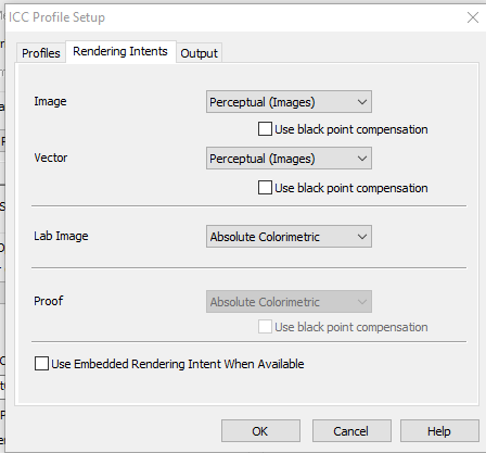

It is most likely the rendering intent settings in the RIP you need to take a look at. If the bitmap and vector rendering intents are different, you will get the results you are getting. I'm not sure how to get to those settings in Onyx but I am sure it is in the user manual and/or someone here can point you in the right direction.
Edit: If this is a bitmap image that you are opening in Illustrator and Photoshop that has no vector data, check the document color mode in Illustrator. It tends to default to CMYK even if there is RGB data in the file.
altereddezignz
They are set the same. I also unchecked to inbed the icc profile from photoshop just now and printed the color. Got the same results.
In both ia and ps the rendering intest in the software itself is set to Relative Colorimetric

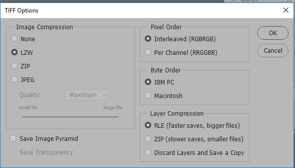

The only thing I can think of is not using compression on when saving the TIFF in PS. Try that out and see if it helps. Otherwise, hopefully CorrectColor sees this tomorrow and can help you out more.

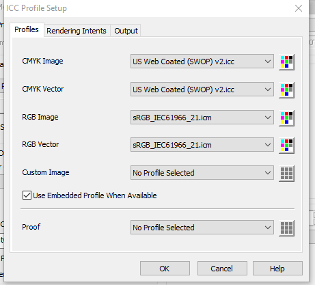

shoresigns
Correct me if I'm wrong, but I thought EPS files couldn't have an ICC profile embedded in them? TIFF files can, and your RIP is set to honor them. Could that be the problem?

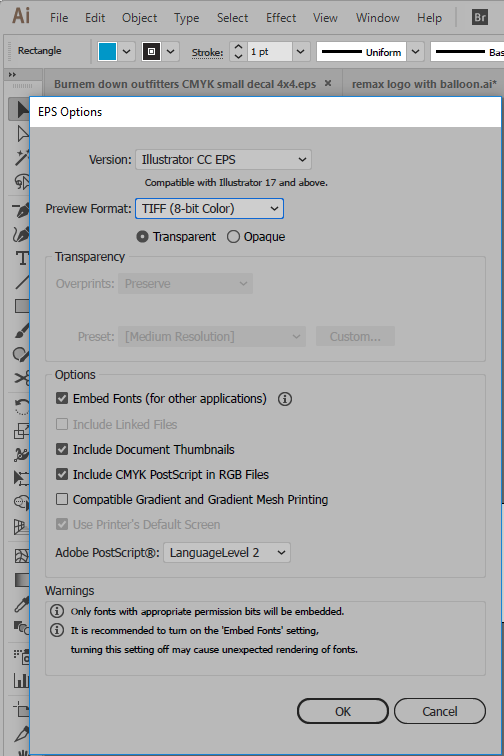

Saved Files as followed
Illustrator
saved as eps
Saved as PDF

Saved as tiff with profile on
Saved as tiff with profile off
Saved as PDF with profile on
Saved as PDF with profile off.

The CMYK mix in all files print the same
The RGB swatch in illustrator matches in PDF and EPS but does not match the Photoshop print.
The RGB swatch in Photoshop matches in PDF and EPS but does not match the illustrator print.
To sum it up. RGB does not match across illustrator and Photoshop but on these colors in particular they do match in CMYK mix in a RGB file across Photoshop and illustrator.

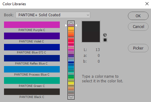

altereddezignz

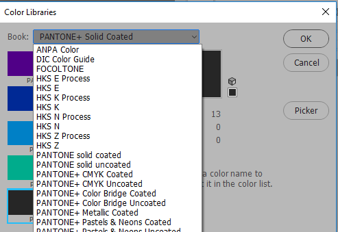

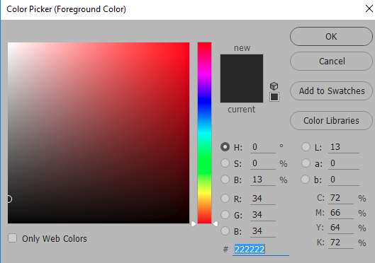

Open the colors or double clock on the foreground color it brings up the color picker.
click on color libraries.
Select Pantone Solid Coated +
Select pantone process blue
then create you image text or file.
Images below.

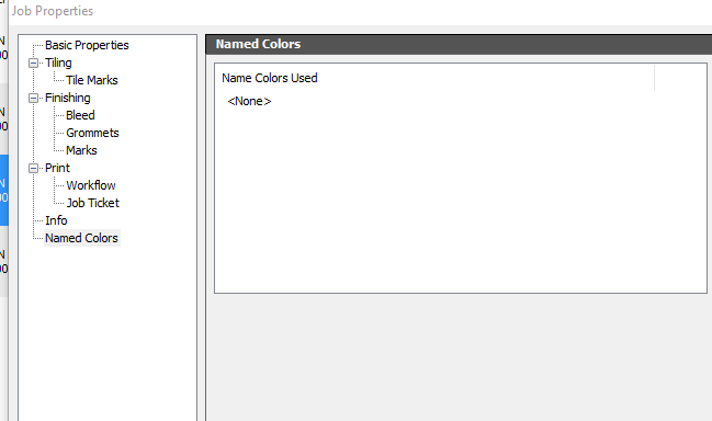

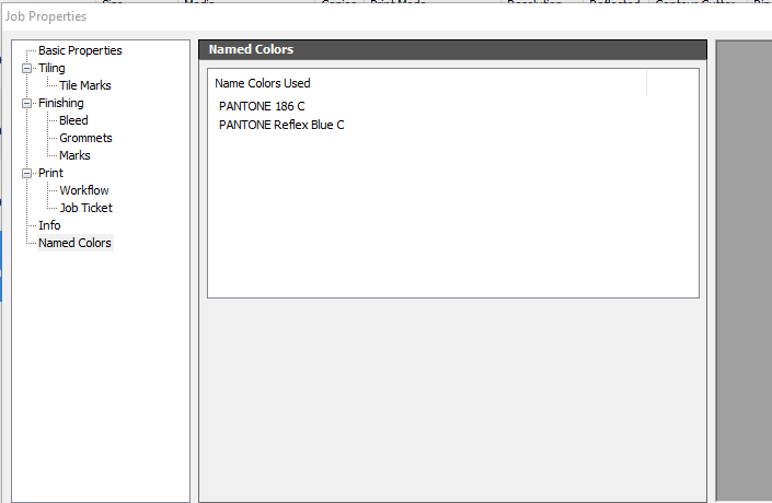

Ok so here is what onyx lists.
I can look at the spot colors it sees.
The one image that shows none it shows it on every file from photoshop
on the one that shows spot colors that is from illustrator eps file
