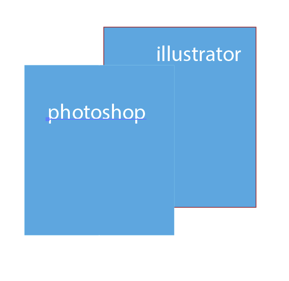

Illustrator and photoshop not printing same blue.
altereddezignz
You need to think of those CMYK value as a output color not an input color. That spot color your wanting ends up being a CMYK output color because that is how the printer is addresses. Because of the way your two color are read/input they output different The Spot Color Library tells what CMYK values based on your color management setting are to be sent to the printer. The CMYK input from raster gets told how to output based on your CMYK input profile covert by your CM to output CMYK values to your printer. Since the Vector Spot and the Raster do not have the same input values the output values will be different. The trick is and what the Color Replacement function should be is so that you can make those two different input colors the same output value that gets sent to your printer. There are also other uses for Color Replacement beside making your two colors print the same.
Your Vector Spot should show the CMYK value that is sent to the printer. If Onyx does not do that then that is a serious flaw, because in your situation you would have no way to know how to make those two colors match on the printer.
Do a test because those Color Replacement values should be the CMYK values that are sent to the printer. In the test you can try this. Make a CMYK input file with just 100% or each of the primary colors. Now RIP with CM on and check those color values with the eye dropper in Color Replacement. You will find they are not 100% any longer. Now Replace each with 100% only of it's color. If everything is working correctly as it should your printer will print 100% of each of the colors. How do you like your Black now!

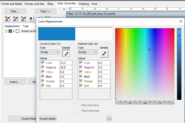

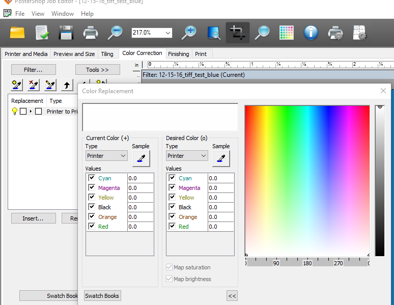

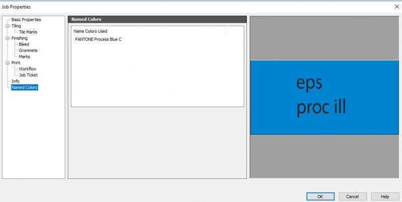

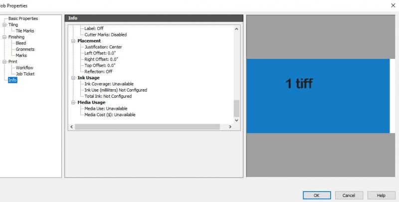

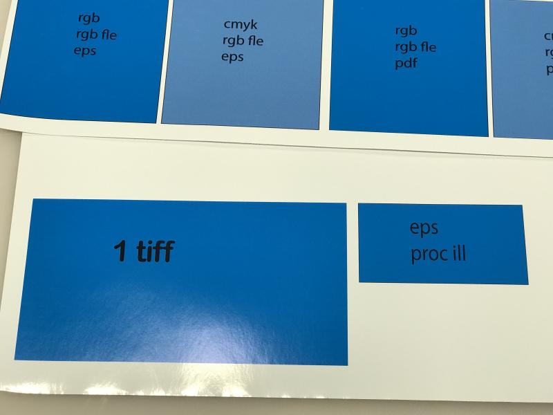

I have done this exactly. Yet it will not recognise it. When you rip a file in onyx it you can go into the job properties and it well tell you the called for labeled colors. For instance any pantone colors it will call out.
As you can see from the 2 images i posted. Both are saved with the same Pantone color. The tiff i have created a spot channel with the name correctly as it is in Onyx.

Ok so I had to rip an illustrator file that showed the cmykro mix to produce the color I need and that is correct. I found the location in onyx to change colors. Loaded the ps file and ripped it. Opened it in job editor and selected the color to change and replaced it with the mix I was given after rip on the ai file. Printed the ai file and the corrected ps file and she printed like a charm and matched. Just a nightmare getting to this point. Now if I could just figure out the saving a spot color out of ps I could just go to a different screen in job manager in onyx and actually just select the Pantone spot color and change it to another.

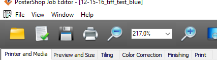

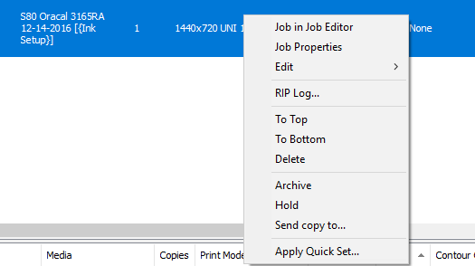

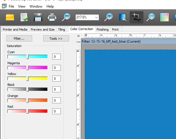

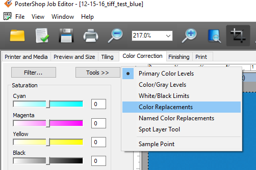

If anyone needs this.
1.Open file in Rip Que
2.Right click on file and send to job editor
3.Click on color correction
4.Click Tools
5.Click Color Replacement
6.Click insert or click the eye dropper
7.Select the color you want to replace
8.On the desired color column enter the color you want to print
9.Click the X
10.Click the submit printer icon.
Make sure you do not re-rip the file. If you do it will ignore any changes you made to the colors.
A few images attached.

I created the 2995c in PS saved it as a .psd in rgb and placed it in Illy as shown I have not printed it but on Illy it matches right on as the screen shot shows I use coated in PS and not the Pantone cmyk. Screen Shot 2016-12-21 at 5.35.00 PM.png
altereddezignz
I created the 2995c in PS saved it as a .psd in rgb and placed it in Illy as shown I have not printed it but on Illy it matches right on as the screen shot shows I use coated in PS and not the Pantone cmyk. View attachment 117898
Yeah mine matches as well till I sent to rip. It's not the software that makes them different or not match. They matched here all day lon in the 2 softwares. It's when you send them to rip they change what they are. Ps sent to rip changes to cmyk from a rgb or cmyk bc is not a vector or dedicated spot color. Illustrator is changed to cmyk but it is
Changed based on the Pantone color to cmyk. This is the reason illustrator prints correctly but ps does not. Now I have not done it your way to make in ps and move to ai then save and send to print. Let me know if it works. I'll have to try that on my Pantone process blue coated.

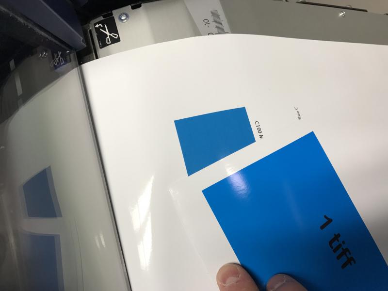

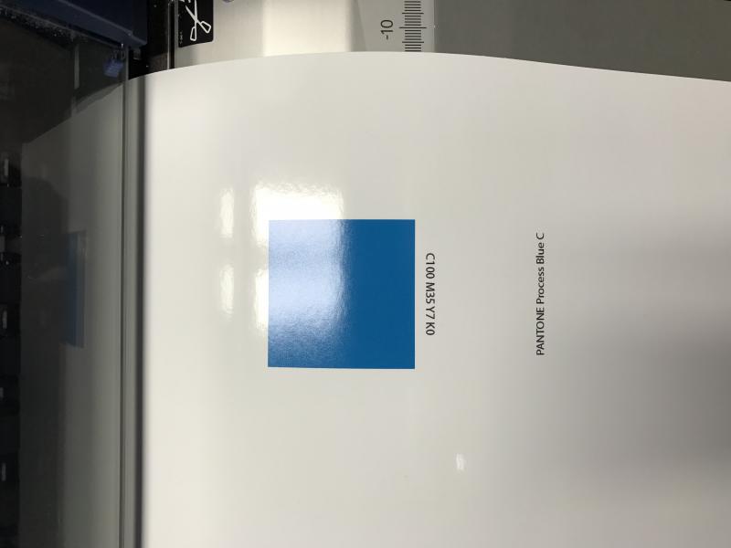

altereddezignz
Here's a PSD file with PANTONE Process Blue C saved as a spot colour. Save it to TIFF with layers off and spot colours ON, then try printing it and see if your RIP recognizes it as a spot colour. If it does, then it should print the same as your spot colour from Illustrator.
Here is the file i printed. It doesnt even see the pantone color from photoshop but it does from AI.
Also as you can see the cmyk mix doesnt match either lol.. The second print i have laid over the bottom is the correct pantone blue from illustrator.
