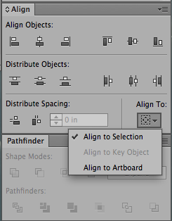

here...

Eric, thank you, that's what I was looking for. That's two things I learned from you today; I also watched a demo of you vectorizing a logo and learned the arrow keys can be used to change the radius of a rounded rectangle!
