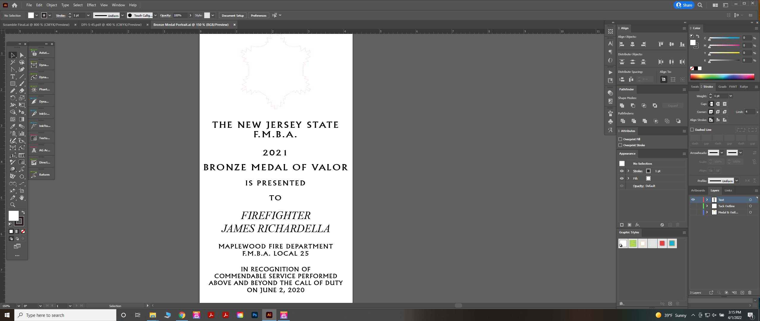

So long story short: Is there anyone willing to confirm this file opens up properly? It should have 3 layers and 1 Variable, with 3 Data Sets.

Opened fine for me. I saw 3 layers, only of which 1 was visible (other 2 are hidden) and 3 data sets. Never have used the variables before, so not sure what that is, but it all looks fine to me and I use the newest version of Illustrator CC.

As Zoogee stated, everything is there once Village font was downloaded. There should be absolutely no problem working with this file. Attached a screenshot of it open in 2022 for proof.
