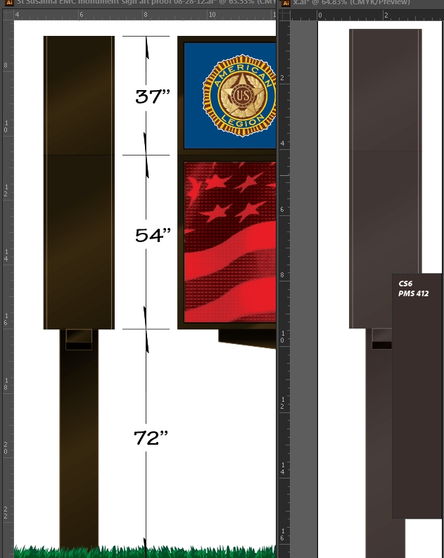

We found a situation that we are not real happy with. If an older file (CS4, CS5) is opened and the contents copied and pasted into a brand new CS6 window, there is a fairly significant shift in color. :banghead:
I have attached a screen capture to show difference. The color displayed in the attachment is a gradient using PMS 412.

Thsi really threw me for a loop at first as well. Your file has Pantone colors specified. CS6 uses the new Pantone Plus color libraries which internally define the colors using LAB values instead of CMYK values.
It's actually more accurate. If it really is a problem though you can get rid of the new Pantone libraries and install the old ones.
Here was a thread on this issue...
http://signs101.com/forums/showthread.php?t=95255
