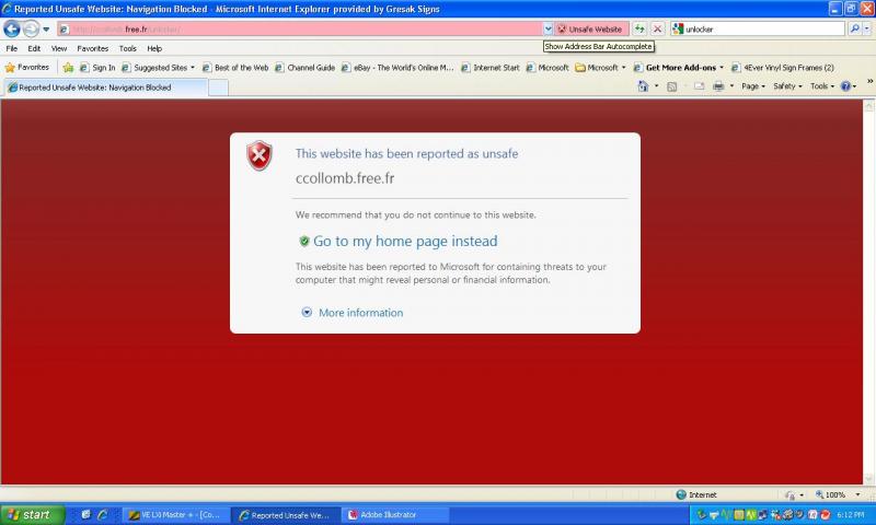

I believe this is the "Unlocker" program? If you look at the end of the address bar (hard to see), it says "unlocker"
Back to my question.....
Is there a proven & SAFE method?
To sad you found a hijack site..
Unlocker is used by the best IT techs around to do exactly what you want.
