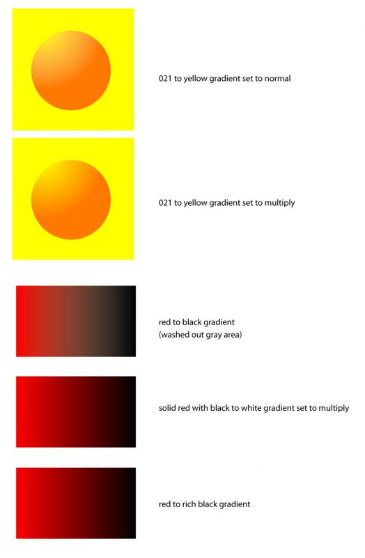

some additional food for thought................blending 2 colors will often lead to a weak mid gradient area.
i've done the attachment as 021 to yellow set to normal transparency. changing the transparency to multiply helps get the saturation i think you're looking for.
also see the same happens with red to black. the fix there is:
a) set a black to white gradient to multiply over solid red
b) blend from red to rich black (100m 100y 100k) instead of black only.
hope that helps some.

Tabaka
Worked like a charm. I learn something new everyday on 101 :thankyou:
