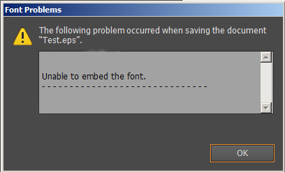

Ai CS6 atleast, does not give the option to export fonts as curves. It asks if you want to embed fonts, but then I've known some fonts that that wouldn't work and it would give you an error msg (see attached). Saving as an EPS doesn't in of itself mean that it's going to convert fonts to outlines/curves automatically. Certainly not within Ai. It's an option within Corel, but even then that option has to be enabled. Depending on what program the EPS file originally came from would determine if it was even an option on export (it may not have been). If Signlab is like Corel, then you probably never noticed an issue, because it had the ability to bring in a font as an outline/curve and then no worries.
Also, I do not recall importing an EPS asking if "you" want fonts brought in as outlines or as fonts. Ai just gives you an error msg saying that it's going to substitute the font for something on your system.
This is something that drives me up the wall, but everyone should know to convert fonts to outlines/curves when sending it out. It just shouldn't be an issue. I understand that sometimes one forgets to do that and that's one thing, but this happens way way way too much for that to be the case.

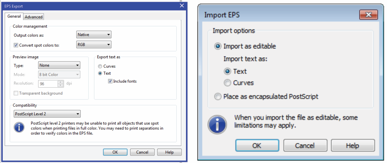

Just for giggles the attached image is Corel's Export/Import options. Corel is a lot simpler than killustrator.
LET ME REITERATE, DO NOT MAKE EPS FILES IF DESIGN HAS GRADIENTS/FOUNTAIN FILLS. PDF ONLY!
We should charge customers extra for providing such eps files.
