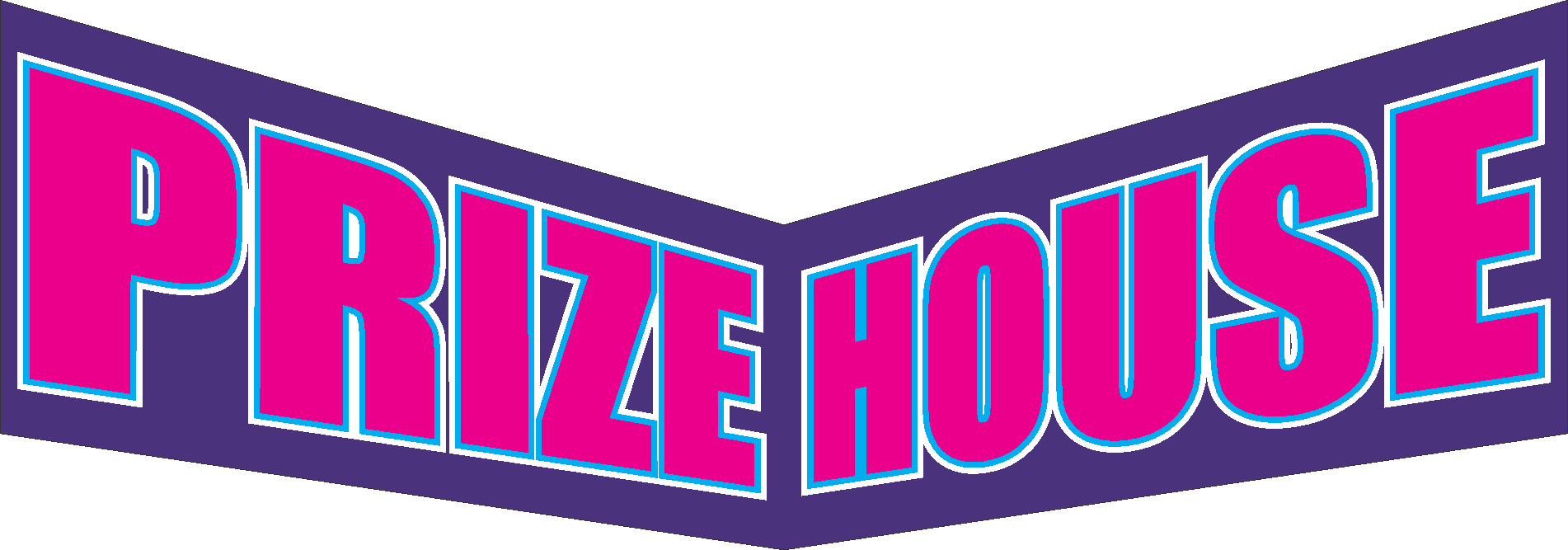

For the life of me I cant get a font (turned into outlines) to look symetrical when I envelope distort----use top object. Not sure if its me or the font itself doing it. Attached is a picture and you can see the "prize house" text doesnt look correct. Can anyone possible help figure out what I am doing wrong? Thanks

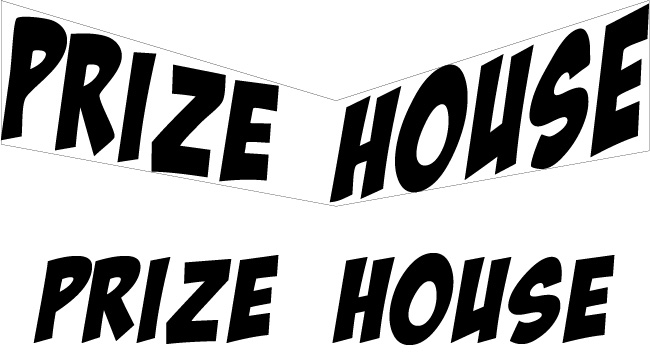

I just tried it the same way you did, envelope distort----use top object, and here is the result. I think it came out right even though I chose a rather funky font choice.

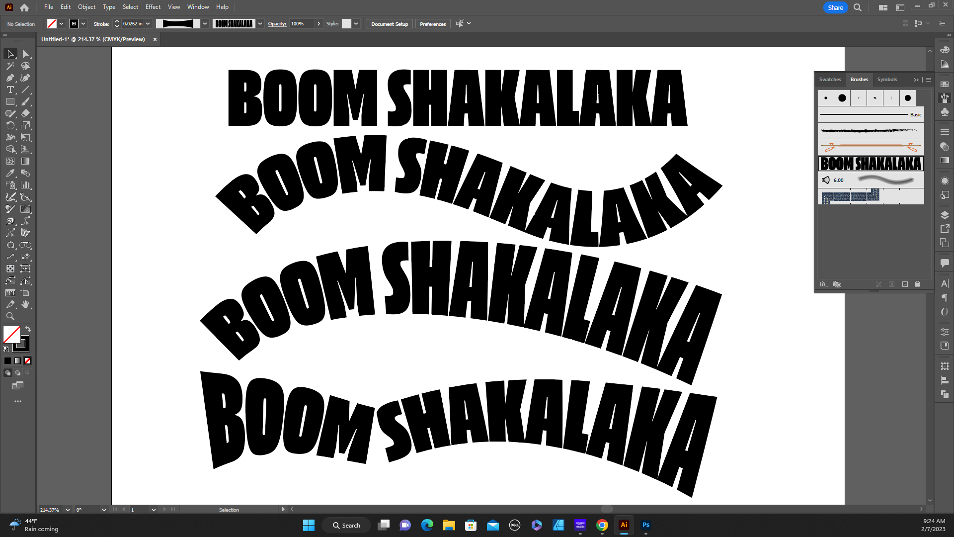

Envelope effects work okay in Illustrator. But I think Art Brushes work better in plenty of cases. In the attached sample image I turned a piece of text into an art brush and applied that brush to a path. The Width Tool in Illustrator can vary the stroke thickness. They're live effects and can be adjusted, perhaps more easily than the envelope effects. Sometimes I'll get the length of the target path and build my text object to fit the path's length more exactly when I want the most natural looking results (the letters won't be as squeezed or stretched).
In the attached sample image the bottom text string is a little odd where the bend occurs. But that's because it's just a single path. For better flow control the path can be broken in two at the corner point so two separate word art brushes can be applied to those paths.
