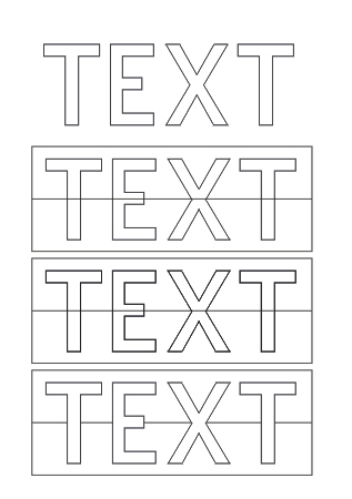

jiarby
You can make them yourself in 45seconds. I do it in Corel. Probably similar in Illy.
make a rectangle around the object
draw the weed line where you want it
duplicate the text object, convert to curves
select the text (curves now) and the line
back minus front
ta-da...

rcook99
back minus front
ta-da...
Why can't you just create your box, draw your weed line, and weld it to the text. By doing the weld it will not cut through your letters. just my .02

AnteVante
I´ve tried the pathfinder but there is aproblem to get weeding lines.
They cut through the text (or other object) when I import to cut studio
back minus front
ta-da...
I have a macro to do close to this. Creates the "box" with 1 vertical line & 1 horizontal. Then I just move the lines as to not go thru anything then click & drag one to the next area and before letting go hit the right mouse button to duplicate any.
