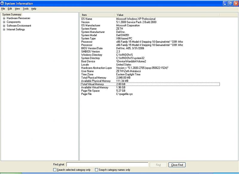

Heres my computer specs as is. My computer has been running terribly slow. I save most of my files to an external hard drive, so I dont see what the problem is.

So should I do some house cleaning, or add another drive?

how many processes are running?
are you running spyware/malware program?
whats your temp file folder like?

it shows that youhave 2gb of physical ram, but only 111mb available. That means that there is 1.8gb of something running in memory..probably something sucking up CPU cycles along with ram and bogging you down.
Look in taskmgr to see cpu utilization and running processes.

First thing I see, you have 2GB of RAM, and 1.9GB of it is being used by something. I can't tell you what is using it though.
For me, I close Photoshop every so often during the day, it clears the memory and things generally run better afterwards.
