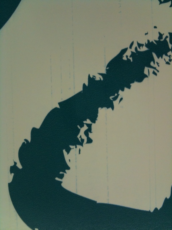

jeremycoressel
here is a pic of the problem.

jeremycoressel
the thing is it starts to happen near the end of the run, the first part of the logo which is gray is fine and the small tag line under the gray which is the same green is fine.
MachServTech
More than likely debris on the bottom of the heads dragging the ink along that it has just printed. Clean the strings/ debris off the bottom of the carriage.
mark in tx
Is that "streaking" with the direction of the head travel?
If everything is clean, then you have 2 possibilities,
1. your profile is wrong.
2. the media is contaminated.
I'll bet on 1.
