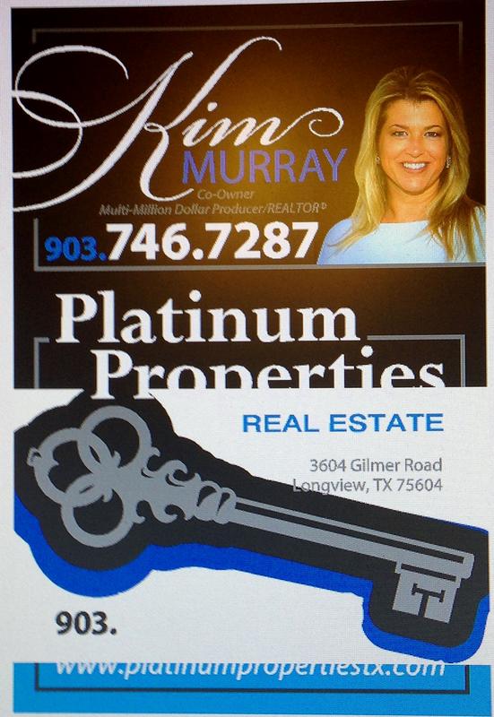

What do I need to do or have the person do that is sending me artwork that has all kinds of layers in the artwork. It will not import into my Flexi 10 correctly. The artwork being sent to me usually has a lot of Fades and Shadows. And has boxes that go outside the borders of the graphic. I have attached the file I was sent and a picture of how it looks when I import it into Flexi and when I click on the file in Flexi that's when you see all the boxes and layers. I'm lost, please help!!!

For some reason, I can only see one of your inserts. Perhaps the other one is too large. I can't tell a thing from the thumbnails. Sorry.

I have been told to have it flattened. Just don't know what that is or does but Thanks for the Info. It's easier to tell somebody when you get the info from someone who Knows what they are talking about! Thanks Again!!!
Tell them to combine all layers and flatten transparency. Then send in .eps format. Should take care of your issues.
Why do you need to import it into Flexi10? Are you doing some editing to it?
Just import it into the production manager and print it from there.
Open your production manager/ select the printer/ click on the job folder to locate the file. It will load without any layer problems.

he would most likely run into issues with transparency over vector issues, unless rendering intents are set to be the same for raster and vector data
