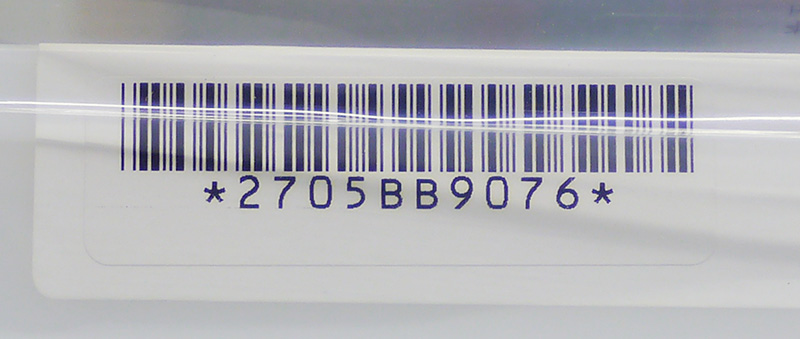

How does one decipher the manufacture date code on Roland ink cartridges?
Bill43mx
You won't get any date info from that. I don't know what the JAN is but it apparently isn't January....I went through a pile of old carts and they ALL say JAN.

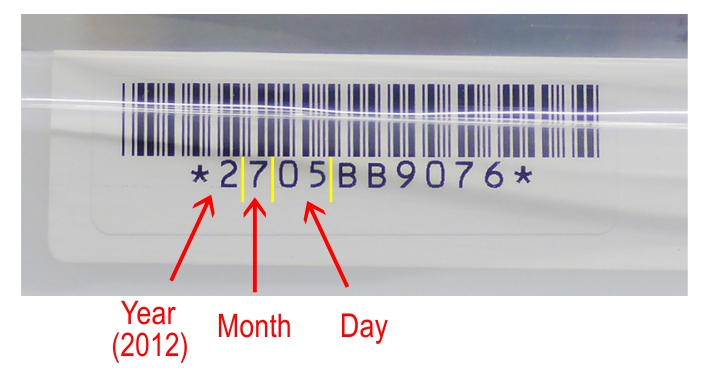

Colin
Actually, I think this is the label which indicates the manufacture date. Anyone know how to properly read them?

Colin

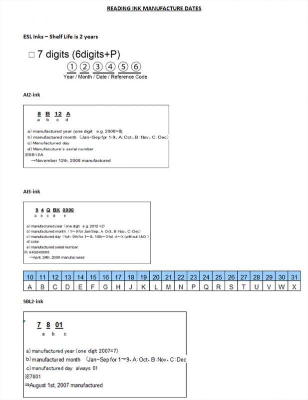

Ok, so after talking with a Roland rep, here's how to read your EcoSol Max cartridges for manufacture date.
(For some odd reason they don't put a "1" in front of the year, and all the other numbers to the right of the day are internal to Roland and meaningless to us end users).
So this cartridge was made on July 5th 2012.
woolly
thanks for that
some of my spare carts have a letter where you say the month should be ??
any ideas
