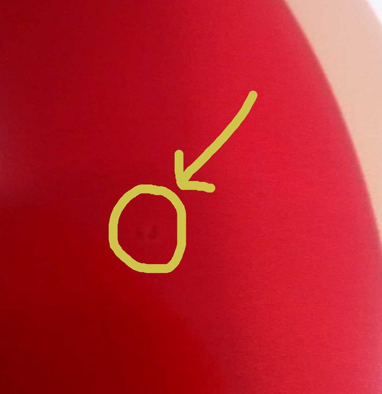

Does anybody know what this might be?
I know my black head (sp300i) has some deflections. When printing solid red it looks like the head is spitting out drops of inkt. It's not contamination on the vinyl.
Fuzzy picture attached.

Piece of hair or lint riding on the head has been my experience. Do a good maintenance cleaning and you should be fine. I use lint free tech swabs and butyl carbitol.
Fiber or hair on the head is one possibility, but not the only one.
Media contamination is another viable possibility. Contamination is not necessarily visible to the naked eye, and will only manifest after ink has been applied. A third possibility is that the media is being over saturated with ink, and artifacts like fisheyes can oftentimes occur, this is generally the case where the anomaly is only visible when printing certain colors.

I think over saturation is the problem myself. Strange since it occurs on all profiles and media. I do notice that ink is layer down much havier lately than before. I haven't altered setting.
As said, using different profiles (and settings high Q, normal), media etc...they all appear to have more ink than i'm used to.
Also I noticed that I have to clean the aluminium plate in front of the wipers more often. Nowadays there is always some ink spats overthere.

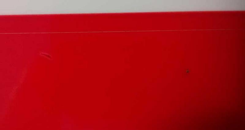

So I replaced the whipers, cleaned the wiper scraper, did a full head cheap for dust, hair etc, manual cleaning and it's still giving me the damn spots in the red. It looks like it only happens in red (spot color 43K.)
I whiped down the vinyl before printing (Oracal 3165) and printed a full set of red bands across the vinyl hoping there would be 1 good. No chance. Random spots like these from the beginning till the end.
I also have the feeling that the inkt is layer down much havier than it used to be. On all vinyls, profiles and settings.

Are you SURE that the vinyl isn't defective?
Or that static isn't putting itsy-bitsy pieces of lint/etc on the actual vinyl surface?
You would have to have a loupe or a digital camera with macro setting to determine that.

I'm not 100% sure it isn't dust picked up by static, but it only seems to occur with printing red and on all sorts of vinyl. And I also have the problem that it seems ink is layer down much heavier for a not known reason. On all vinyls, profiles, settings etc.

The deflection is no problem. I know about it and a new head will be installed soon. I'm not looking for a solution fore the deflection. I was just wondering if the problem I have with the heavy ink coverage and the spatters in the red can be caused by the deflections or not. If not, than I seem to have another problem that needs to be taken care of.
