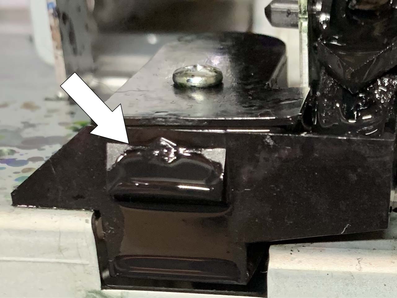

Got a weird one. This started after printing a trailer wrap if that's a clue. During auto clean or manual clean ink comes out of this plastic piece.(see arrow). It is below and to the left of the wiper blade.
There are two holes in it (covered in ink in the photo). Drain lines from capping station are clear and flow cleaning solution and ink. Apparently not enough. Looking for suggestions.

Behind the wioer blade there is a channel that runs ink to the tubing. Sometimes that builds up with ink and needs to be removed. I use a the sponge for cleaning with alcohol.

Cleaned out some crud but it still barfs out ink. Pump seems to be plenty strong just not getting much flow through the drain lines. They are almost ink free at this point and I can see dribbles of clear cleaning solution going through them.

Fixed it. Drain line was clogged by a big piece(~4") of petrified ink. At some point I'll probably have to get another chunk of hose.
I have my theories on why this happened. If it doesn't clog with the new ink I'll have my answer.;)
