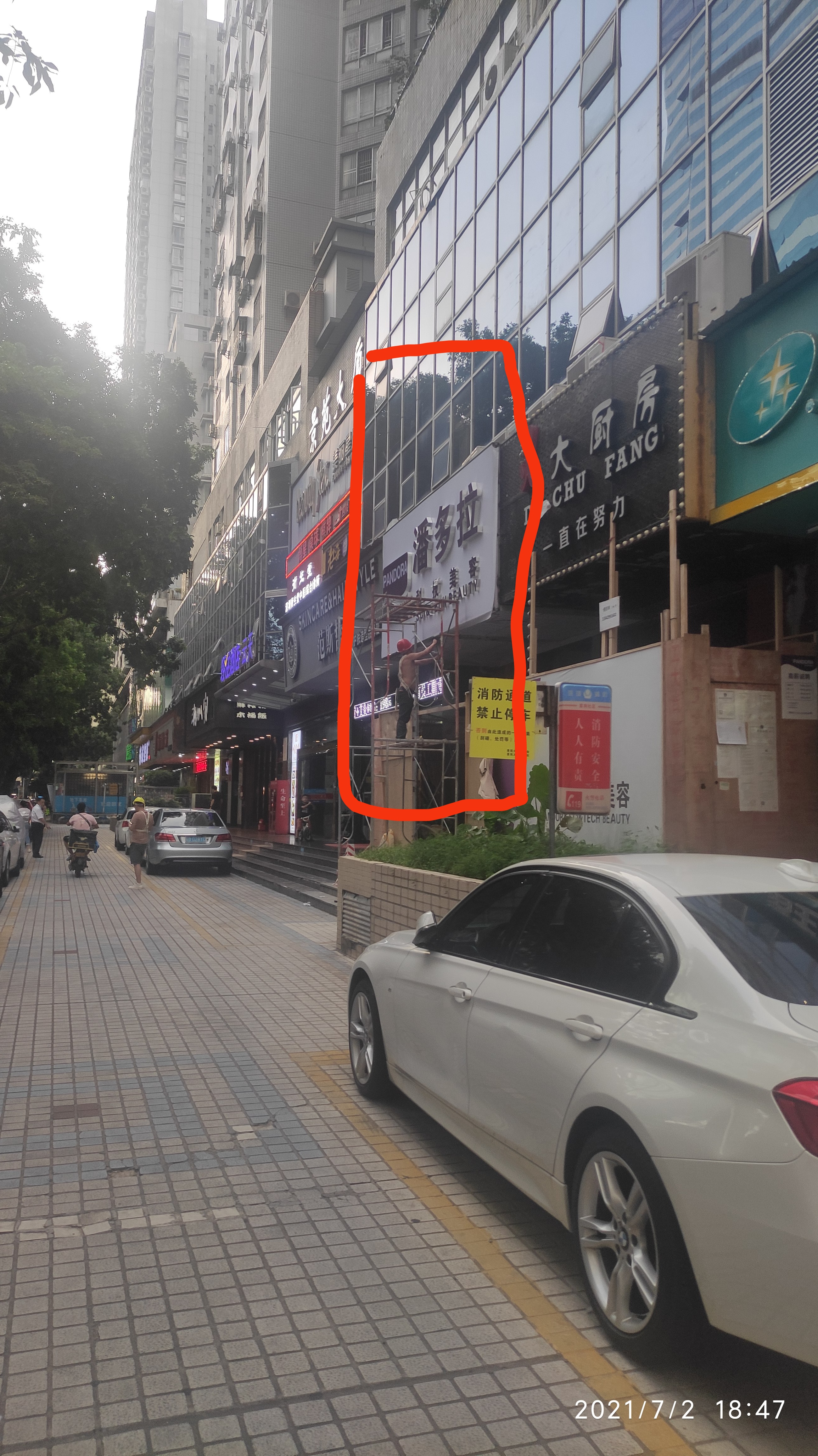

Has anyone ever seen an installation like this before, chanel letters adhered to banner material, I see It often and It's amazing that It never falls down.
unclebun
I doubt they are adhered to the banner wrap. Unless they are packing them with some serious lithium batteries, they are wired the traditional way, through the wall. That means there are studs through the banner too. On the other hand, if the banner isn't flush with the wall, but they use something hefty like Cooleybright or even thicker, as long as the letters are super lightweight, I could see attaching them with multiple small fasteners would work.

I've seen this done at old navy stores, there is a 1" tube frame that hits mounting points behind the letters. Something like this solid background seems really easy, it's only super annoying when the banner has graphics that align with the letters and is then illuminated also, requiring a lot more alignment time and for the frame to be notched away as to avoid shadows.
The only thing that was in the box was rows of LED's no frame tubing what so ever except for the box It's self, the only thing that's holding It is the outer edges of the box

The faces on some of those Chinese character channel letters must be a bitch to get on... Its hard enough for me to put on an "M"

Give me a single M any day, it's the scripty letters they stitch together that really ruin my day. For instance, Freddy's overall sets pushing 18' long... (This one actually looks pieced together, not the ones I've had to deal with.)
Huh, I wonder if it's a shallow enough box, allthread could support the letters, though as light as we make them, I can guarantee Chinese made channel letters are 50-75% the weight of ours, hand welded together, I suppose the banner could hold them with a heavy enough material... Why didn't ya just ask tha

Huh, I wonder if it's a shallow enough box, allthread could support the letters, though as light as we make them, I can guarantee Chinese made channel letters are 50-75% the weight of ours, hand welded together, I suppose the banner could hold them with a heavy enough material... Why didn't ya just ask that guy?
They didn't speak any English, the box looks to be 4 inchs

we've mounted channel letters atop a flexface cabinet before.... the secret's in the sauce, but they're definitely not just "hung on the banner".
