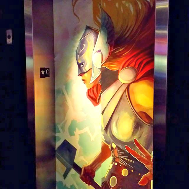

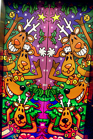

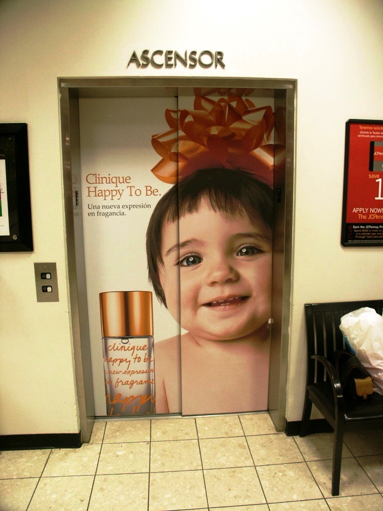

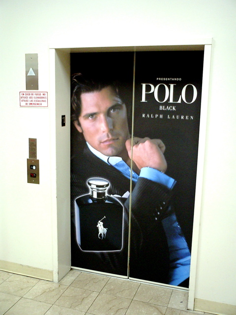

Photo Tex has been used on many many elevator doors over the year! Always happy to send a free sample walterjr@phototexgroup.com
