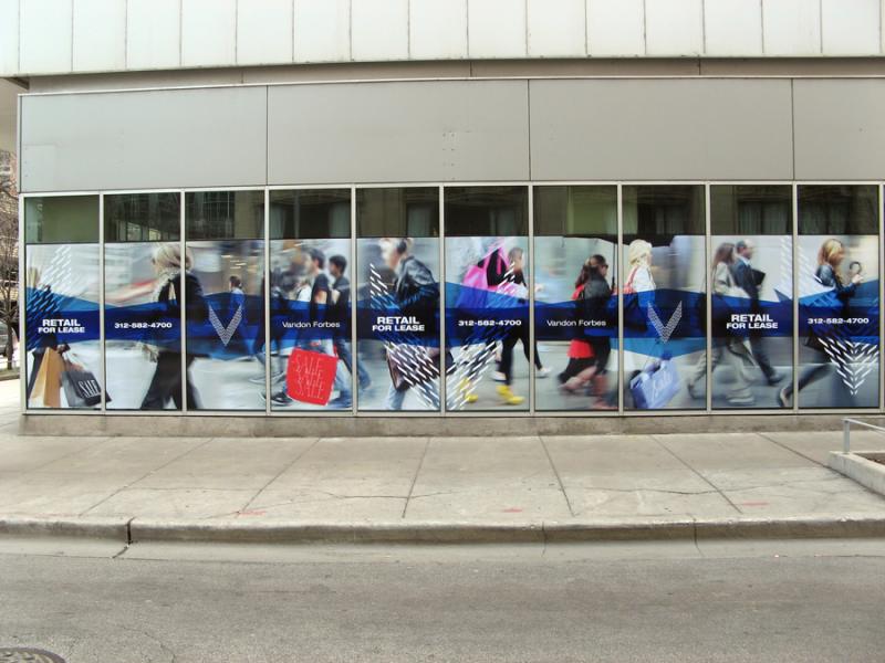

Just installed dry Oracal 651 vinyl on 10 windows 45'' x 90''
Practice + Practice + Fun :thumb:
correct me if I'm wrong but 651 is cut vinyl, did you print onto it?
If so why? was there that much of a price difference for you not to use a printable media?
Sign Up Graphics
Hey 2B,
I'm sorry for the wrong info.
Was printed on 2.5 mil Oracal orajet 3651 includes matching laminate. :thumb:
