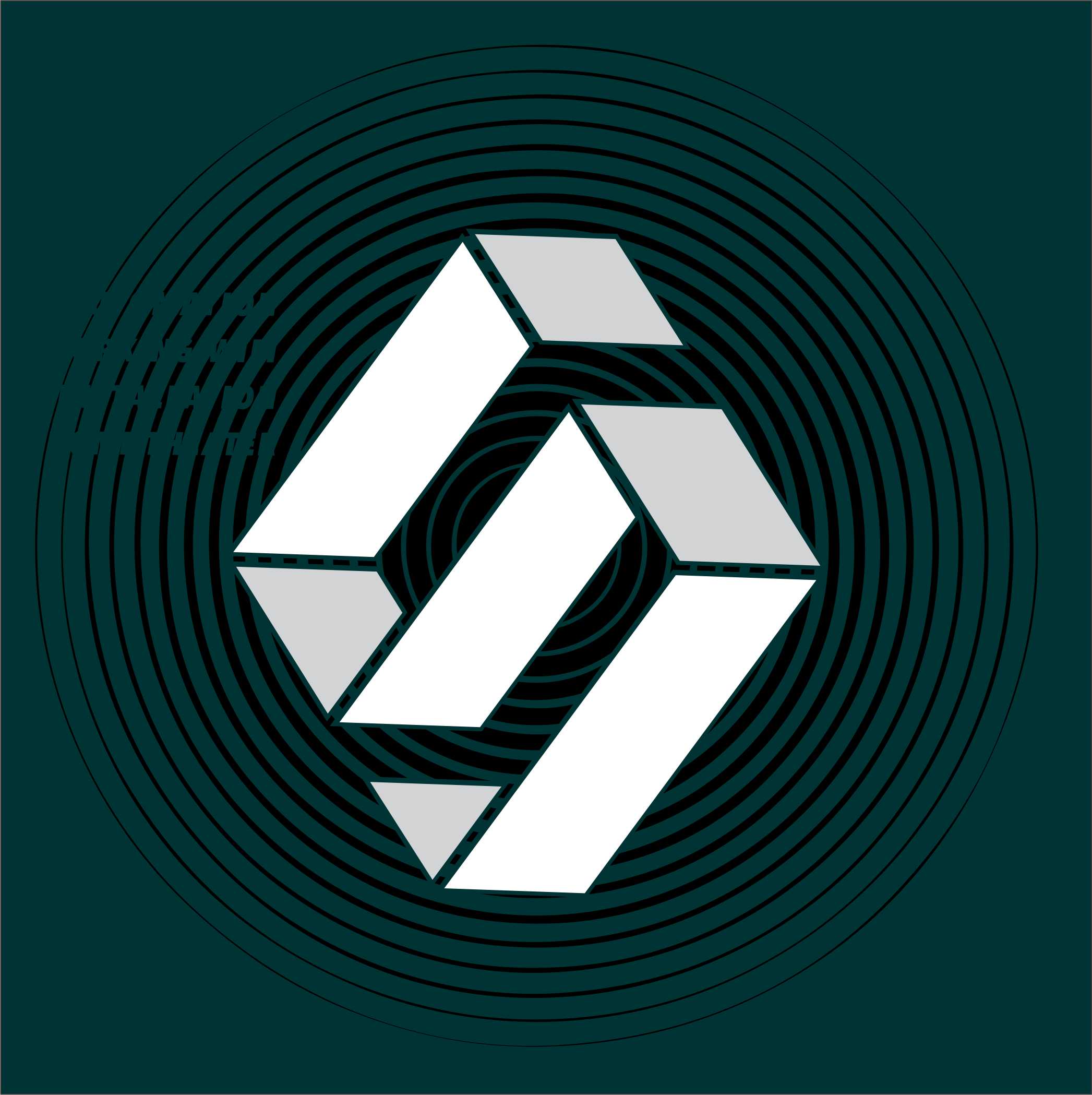

Hey guys, I have an interesting design I need to install in the next week. I am pretty sure there is only one proper way to do this but not sure enough that I don't mind asking for some advice.
Looking at this design am I correct to just print and contour cut the whole design and pre-mask and install as one whole piece?
Thanks! Any install tips appreciated.
Main question was should i do the text separate and/or the black radial lines separate?
Was thinking if I did the radial lines separate I could design it so that it left a .5" gap between the radial lines and the "S" logo and then install radial lines first, logo fits inside, and maybe do the same for the text on the top left?
Or is overlapping at some point an option?
Thanks!!!

If it were me ,i would do the radial lines, and then add the lettering and place the S as needed..And you can overlap ,its a matter of preference really.
MikePro
I HATE overlapping lines, especially on small copy. Agreed it's a preference thing, but my preference would be to avoid it by adding your "S" and additional copy to the radial lines, install as one piece, and then overlay white vinyl for your "S" & text.
