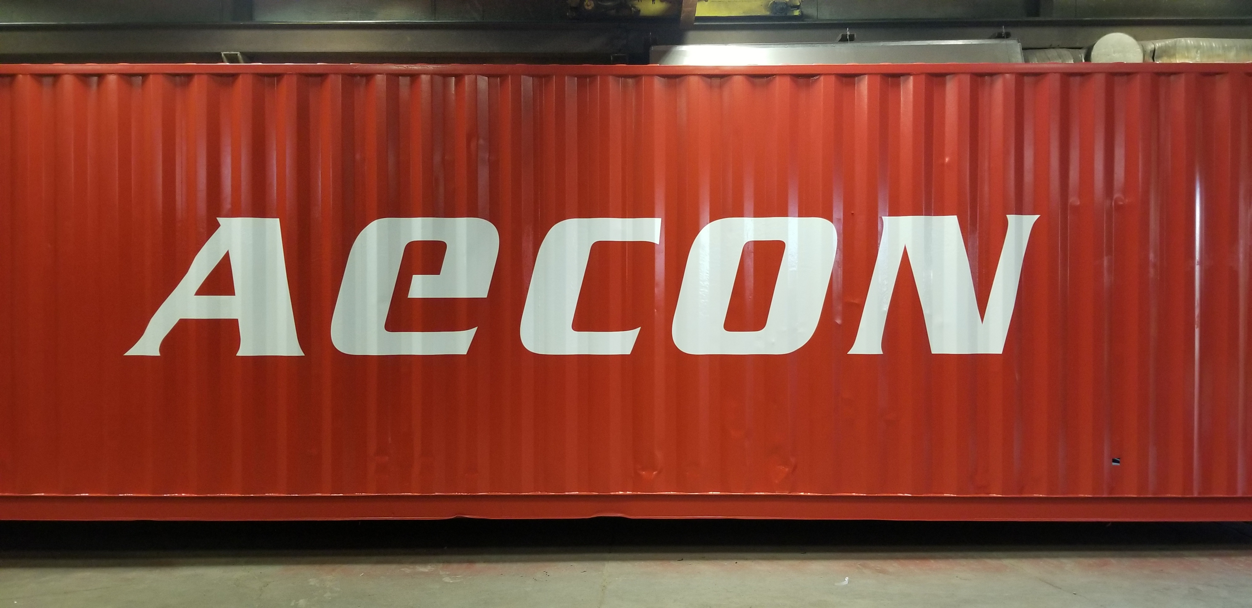

Hi All, we don't normally do signage on items like this but we have a really good client looking to have their logo put on a couple seacans. They're fairly corrugated so wondering if there are any tips anyone could share to help with the install. Their logo is very simple, 5 letters @ 36" is what it will be, 2mil cast white vinyl.

as your image shows, the graphics will be distorted by the ribs and valleys.
our installer does a vertical hinge and works the graphics from the middle out
if you want the image to be easy to see, take a substrate and mount on top of the ribs, will give a flat surface so the graphics are easy to read from any angle.

measure how much the vinyl will travel in and out of the valleys and stretch the logo out the same.
hinge on the side. I have done this before and it looks great.
Chaz
