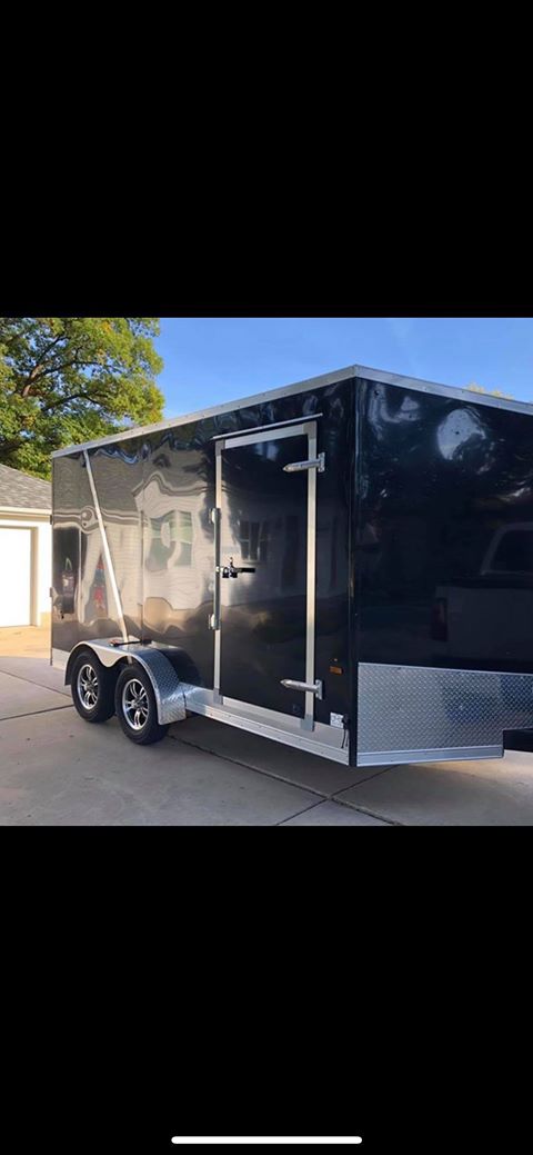

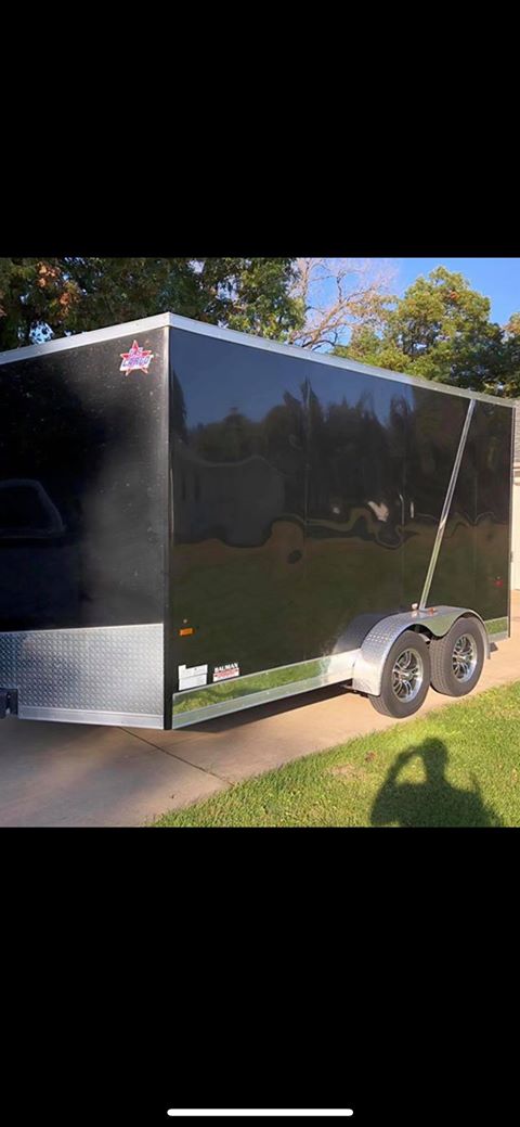

So I'm installing a single color (Oracal 651 Metallic Silver) on the trailer in the picture. I'm wrapping that silver angled metal piece with chrome delete vinyl first, then the main decal goes on after.
My question is will going over that metal strip disfigure the design and how can I get around that? The decal is 8 ft long.

It's hard to tell from the photos. I don't know what the graphic looks like either. Really does it even matter because if you can't remove it... it is what it is. Just tell the customer it won't look perfectly flat and if they are super picky about it tell them to buy a normal looking trailer or avoid going over the chrome thing altogether.

1. I’d use a cast vinyl not calandered
2. If installed properly the graphic will not get “distorted”. Just cut along that bar and finish application to the trailer.

Cast isn't an option at this point, all I have is Oracal 651. I may start to make the change to 751 when ordering new vinyl, seems to be a better option than 651, just more $$$.
I'll get it lined up, add tape reference points, and just cut down the side of the metal trim and just see how it goes. This thing is going to kind of be a nightmare being 8ft long and I have T-Rex arms lol.

If you would have read the entire statement you would have noticed "decal" in there. I'm not wrapping the entire trailer in silver metallic vinyl, I'm wrapping the metal angled piece with black, then the decal applied.
751 is out of the question since the decal is being applied on Saturday (I have to order all vinyl and can't have it here by then).

I normally get my vinyl from Fellers, if I were to order it today/tonight it might be here tomorrow but most likely Monday. I've already scheduled with the customer for Saturday morning (I'm cutting the decals tonight). This isn't my "profession" per say (I'm a systems admin / pc tech by day), this is just a side job for some extra money. The market around here I can't see sustaining a family of 4 very well working out of a basement (I could be wrong).
I ordered Avery Dennison 4in x 75ft Gloss Black Vinyl Roll for Car Chrome Delete Vehicle Wrap ($50 Amazon) to cover the chrome strip. Per your suggestion / recommendation as time goes by I'll be replacing my 651 rolls with 751 and 751RA series vinyl. 99% of my work is on vehicles.

1 - I'd vinyl instead of Paint it... I can't fault op for that. I vinyl for a living, not paint.... I know I can do a good job with vinyl, where as with paint it'd probably look like crap coming from me. Paint has its benefits.... But so does vinyl. If the customer I happy with the price, I dont see it being a ripoff or scamming / over charging the customer.
2 - id never use calandered on a vehicle, a d I wouldn't advertise I only use cast when I don't. not knowing 651 isnt a cast.akes it worst. There's no problem with doing wraps as a side gig... But If you don't know what the main material you use is.... How can you do the job properly? Take some courses, work at a sign shop... Do something to increase your knowledge if You want to keep doing wraps.
I would t goto harbor freight, buy a spray gun and offer to spray paint peoples cars with zero knowledge what I'm doing. But it sometimes fees like that's what people on S101 do with vinyl... Buy a used plotter for $200 on Craigslist and then offer car wraps.
You need to crawl before you can walk. Have you ever applied an 8 ft decal with no air egress on a smooth metal vehicle before? You're going to have one hell of a Saturday if not....
How to do it without it distorting? You can't. But the eye adjusts... If the vinyl is on the raised bar, you'll only notice it from 6" away. That said calander vinyl shrinks... So.when you cut it at the bar, which you have to do... In a few months to a year it'll shrink And you'll see the under color.
Part of being a good company is seeing the obstacles and designing around them. Ie: big 5" bar? Don't design a face to land on it. I don't know what your graphics are, or how complex they are... But hopefully you designed around the vehicle.
I usually despise wet Install for anything aside from window installs... But in your case, I'd look up wet installs if you don't do them...

First off placing a decal on the trailer over the angled strip will not distort the image, it is what it is and it has to stay. If you are covering angled piece with vinyl to hide it it should be just fine. As far as what vinyl you use thats your business and that is not a question you asked when you posted this.
When you are doing decals or painting stuff going over elements on trailers or vehicles is better than trying to work around them, it will be just fine in the end
This Avery Dennison chrome delete material that you mention is cast material, SW900 to be exact. Putting calendered over cast is a big no no. You'd better find an excuse to reschedule this job and order the right vinyl or you'll wish you'd done this right the first time.
