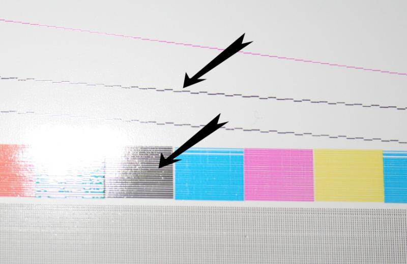

I just rebuilt the pumping station, Installed new heads, head ranks, and new dampers. Now I have these very uniform white strips and zig zag lines. Any Ideas?

Yardbirdrc

randya
these look like 'deflected' nozzles
Can either be from dried ink around the nozzle itself (head soaking will usually help)
Or from damage to the nozzle itself.
Either way, looks like all nozzles are firing and should make little differnce in your finished print.
